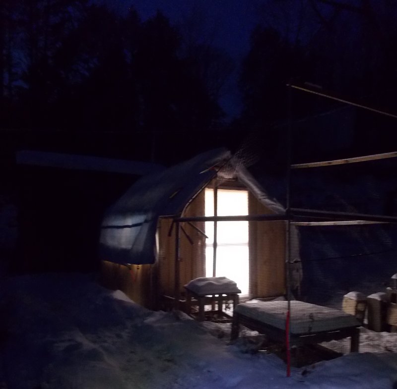

Careful it can get addicting, in 2016 I built a raised garden with plastic 55 gallon drums cut in half on our rocky hill. The next year made a greenhouse. Last year added another garden. I can enough tomatoes to last until we have more to pick.
I grew a whole bunch of ghost peppers in the greenhouse last year and grow salad greens through the winter.

mbenz, I grow cold tolerant greens arugula, mustard greens, beets, spinach, to keep them from freezing I have some overhead incandescent lights on a thermostat they kick on at 38 degrees.
I insulated the north east and west walls with 3" insulation a freebie from the school redoing their roof, I got a whole pickup truck load. 30" up the south wall is insulated too. I throw a double folded white tarp over it at night makes a big difference on heat loss
I have a watt meter on it I used just under 200 kwh for the winter so at our rate about 42 dollars worth of electric. But I have solar on the roof of my shop so most of that came from the panels, at our electric rate the panels are close to being paid off in the 7 years we have had them.
