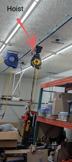

I have a loft situation that I struggled with overthinking for months. I finally came to the basic solution of two dual pulleys and a rope that is capable of tying into a basket or flat cart-type system. It was tons cheaper than all the other overkill ideas and has worked fantastically. In your case, I would add a track system from a sliding door type of track on the ceiling with pulley wheels so you could move it along the racks. Like others have said. Light stuff on top, heavy stuff on ground level. If you can't hoist a box of stuff up to the top level with it I'm worried about you. :) This method will handle 250-300lb. easy. A 600 lb engine goes on the floor.
I'm a terrible communicator lol.
I just took these pics. I think they'll explain things better. The ceiling mounted track channel uses a channel called strut channel or unistrut. It's just another kind of channel system. The final pic is an up-close pic of the hoist and it's trolley type system that lets it roll back and forth on the channel. It can handle about 700+ pounds. I think you can see the benefit of all the effort that has gone into said system. I just know I can make use of it somehow.

I wanna lift a load that let's say is around 24" x 36" x 8" high and weighs up to 350 lbs via an electric hoist. I withheld any thoughts I'd had because I didn't want to pigeonhole the conversation or take anyone off down a rabbit hole that I tend to find myself in but an example would be a low-as-possible hanging ballast weight under the load. With lighter weight containers it would work ok but not so much with heavier. I can add an additional trolley bracket to the trolley (or even 2 more for that matter) to create multiple points along the y axis. That would mitigate spin and tilting parallel to the racks but my chief concern is the load tipping perpendicular to the shelves.
Does anyone have any ideas about how to stabilize a load like that?

Not a structural engineer so if someone qualified tells you otherwise then listen to them. Yes this is a bit Rube Goldberg but if you aren’t going to invest in a commercial rated unit this may work for this situation.
I’d try a simple box frame - plywood rectangular bottom platform larger than your largest container supported with 4 segments of steel rod or flat bar (length to accommodate your tallest container) going up to another identically sized piece of plywood that will be connected in the center to the hoist hook/shackle. You’ll most likely have to reinforce the upper plywood to distribute the point load where it connects to the hoist or if you can competently weld - build a reinforced frame and skip the upper plywood.
If a qualified welder welds up the whole frame it’ll be even more stable.
It can still pivot when loads are unbalanced but you should be able to manage that by hands on control and/or tag lines (and rebalance the load as needed. )
Put removable 1/2 wall sides on it so that if the load does shift, it won’t fall off.
For loading and unloading at height put a clip on each of the two corners closest to the shelves (probably on the bottom corners) and clip them to the shelves for stability. Not sure how the shelves are made but it looks like they’re wire so it should be fairly easy to clip securely to them- you may need a webbing loop to get a clip where you need it.
Use materials adequate for lifting a much heavier load than you anticipate (someone who knows can correct me but I think it’s a factor of 3 for lifting).
As always assume the load will fall and stay out of harms way. A falling load will take out an adjacent ladder so plan accordingly.
There are undoubtedly better ways but if done right this would be safe and relatively inexpensive.

A podium ladder could be nice for this. Hoist the load then climb the ladder and have a nice stable platform to stand in while you position it.
With that said, do you really need to be hoisting 350lb loads that high off the ground, especially in such a tight space? The heavy stuff can't be kept low?

A type of “pallet” for the boxes to sit on in storage, with an eye bolt on each corner, and stops to prevent the box from sliding off. Then use a removable four way spreader chain with a central hook for the hoist. It will pivot, but if the weight of items in the box are evenly distributed, it may work. An advancement of that is an adjustable engine hoist bar with the chains attached to it. This would allow some balancing of the load before committing to lifting more than an inch or so.
