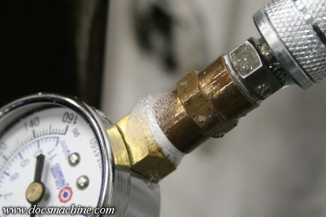

I'm closing in on finishing up a Rapidair/Maxline install in my shop- between the two-bay garage and the small machine room adjacent, I have seven outlets, and the whole thing is a mix of 3/4" and 1/2". Most of the runs are 3/4", with some of the smaller drops (mainly just for blowguns) being the 1/2".
Anyway, it's not by any means complete yet, but today I finished up enough I could pressurize what's up so far. I don't have a proper connection to the compressor, so I just whipped up a couple fittings to make a male-male QD connector, and hooked a hose from the compressor into one of the drop fittings.
I pressurized the whole system, and after a couple snafus, got it up to about 104 PSI on a gauge plugged into another QD outlet. I then shut the valve at the tank to isolate the entire system, hose, gauge and all.
Now, some five hours later, it's down to about 84 PSI. At that rate, the compressor will run roughly three or four times a day just keeping the system charged. My current setup, with just a single hose run straight off the compressor, might run on it's own once a month if I'm not using it.
I'll be hitting the system with some bubbly-water in the morning, but I'm curious what sorts of leakdowns some of you guys might see with similar Rapidair/Maxline systems.
I understand that with all the connections and whatnot that some leakage is inevitable and unavoidable. But having the compressor run multiple times a day just keeping the system charged is not acceptable.
Doc.
