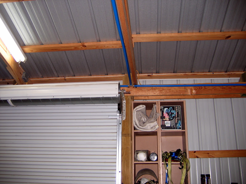

It is very nice to install. I ran it from my compressor to outlets at the two main overhead doors in my shop and put reels there. Much easier than dragging a long hose, and since I went with the 3/4" I get good flow way out from the shop when I work outside.
I imagine coiling can be an issue. I unrolled mine out in the sun for several hours before I installed it.

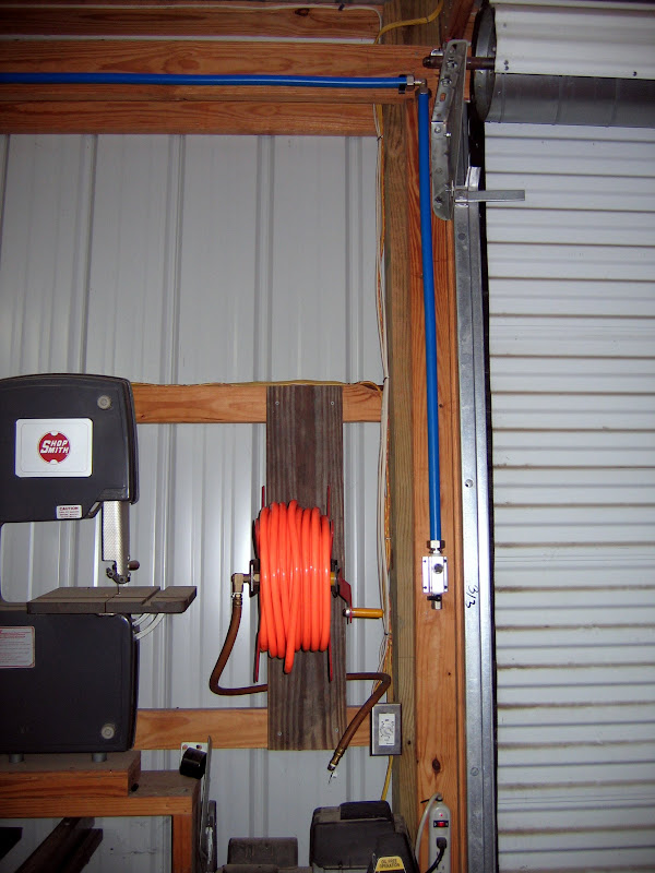

I used the 3/4" Maxline when I got my Quincy and I couldn't be happier. I think it took longer for me to get the hard line from the compressor done and leak free then to do the rest of the system. I found the easiest way to get the lines straight is to get it close on the ground and then bend against the clips when installed.
IMG_1657.JPG"

That is not a bad spot for a reel on the hoist. The crank job on the wall is fine too where there is room, I have some of each, I like it as good as a retractor.
