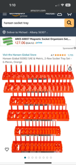

The Hansen socket trays (or a comparable knockoff) are the best way to go. Compact and easy to see what you have or what's missing. My socket drawer has the HF versions for 1/4", 3/8", and 1/2" drive in both SAE and metric. Larger sockets stand up on their own next to the trays, and oddball socket sets like 8-point, tap sockets, oil wrench sockets, and bolt extractors are on their own $0.99 socket rails. My ratchets are in a smaller drawer right above the socket drawer. Wrenches are in another drawer on the tooth-shaped wrench holders.

The Hansen trays are good, though unfortunately for anybody with heaps of 3/8 of whatever, the different sizes aren't available separately.

If you ever want to pick up the tray and move it, Hansen’s probably aren’t the best route. Hard to know what to do with your hex, torx, stubby, 1/8, 4.5, double or more square and other oddball sockets. Traditional rails are very easy to modify, and flexible in arrangement and accommodate everything. Kobalt makes a $8 magnetic tray without set locations for the sockets or whatever which is useful. If you don’t have to lock your box, sticking the various magnetic options to the outside of your box, sure frees up drawer space and eases access. I think rails still win for packing density.

If you are just looking to organize in a tool box or on a workbench then the peg style Hansen socket holders are hard to beat if you don't have a boatload of sockets. Harbor Freight sells their own version of the Hansens for a fraction of the price. For extensions, wobbles, reducers etc a 3 dollar bar magnet from HF works pretty well also.
