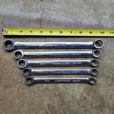

My favorite ratcheting wrench of all time is the Matco Proswing series made in the USA by Armstrong back in the day. It's a standard length set of wrenches that have a zero offset 72 tooth (later 90 tooth) 12 point (later spline) ratcheting boxed end on one side, and a fixed 15 degree offset boxed end on the other side. Unlike all of those long and extra long versions on the market today, the Proswing with its standard length was much more useful. :beer:
For anyone interested in these, there’s a partial set on eBay now:
