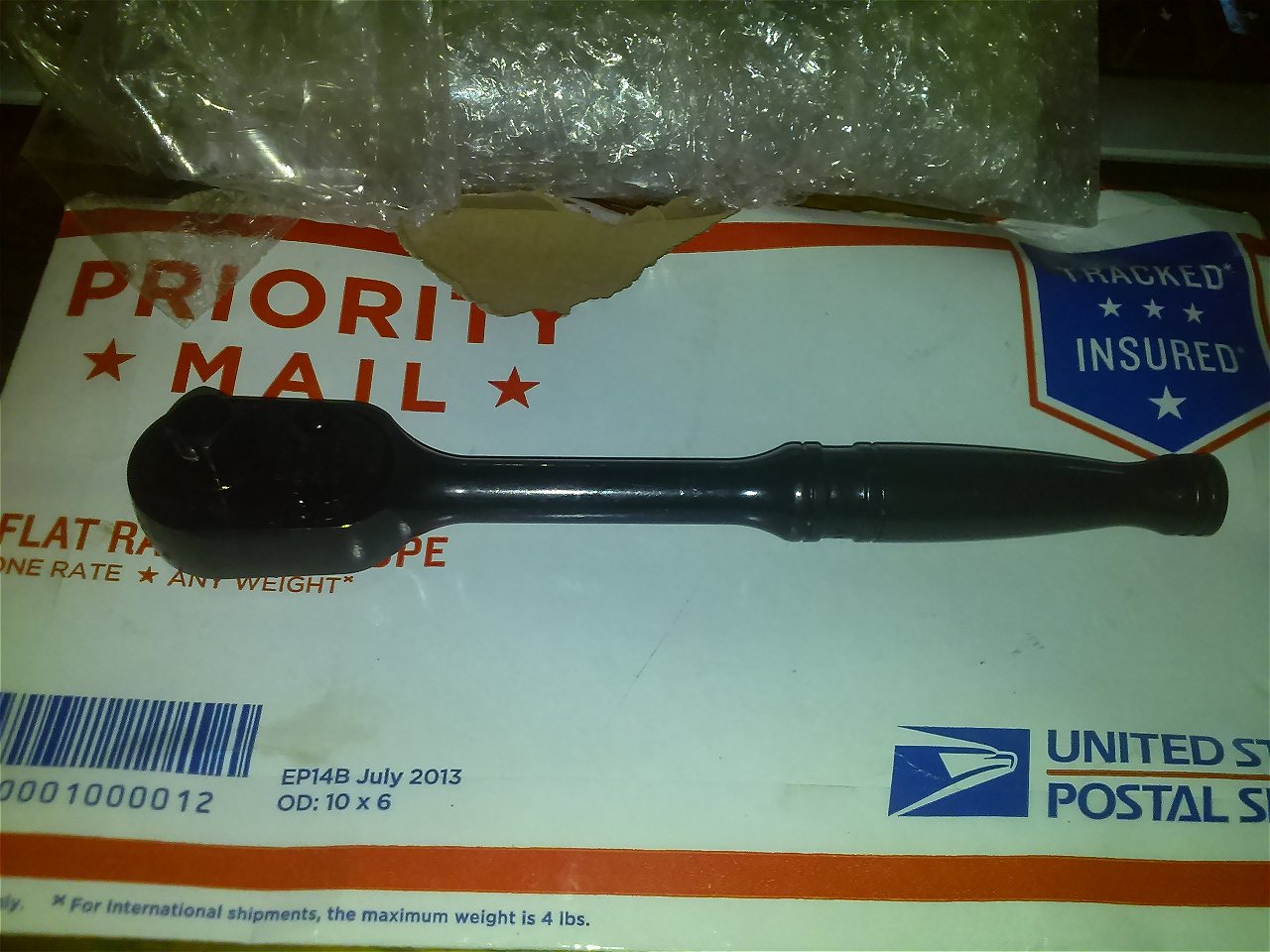

This is the one I bought off ebay last week, it arrived yesterday and I only just got finished with my first job using it: New alternator on a Honda Accord. I turned a few bolts with my old ratchet to compare.
You know, it's a bad picture, but I've looked, and there are no good pictures of it; it's just hard to take a picture of.
The first thing that I noticed was how smooth the ratchet was; to be fair, this is coming from my old Kobalt/Williams 13-tooth model, but I asked to look at a Gearwrench 84T at the parts store (getting the new alternator), and it was nice, but not nearly as nice as the GF80.
The short swing arc was very nice, though, especially while using u-joints, which have some slack, anyway. It also feels solid in hand, although part of that is my general distaste for chrome; it feels thin and greasy. Chrome is also blinding in bright sunlight.
The detent pin is perfectly sprung; for a ratchet without a quick release button, this is crucial, and they hit the sweet spot. Any stiffer would be annoying to remove sockets, any looser and they might fall off on their own.
One note is that I did not find the backdrag particularly low; it has a fairly stiff pawl spring in there. Granted the GW was worse, and if the 120XPs are worse than the 84Ts, I can't even imagine. The old Kobalt/Williams unit is loose as a goose, even if it does have a 47° swing arc.
I have noticed some lubricant leaking out of the head, although from what I have read, this is supposed to be normal for a new or freshly serviced ratchet, is that correct?
Overall, I am very happy with my purchase; at full price, I might have a different opinion... but then, if I had a shop and had cars backed up waiting to be worked on, I might have yet another different opinion :)

That's a good looking ratchet - the industrial black is really nice!
I admit that the black finish played more into my thinking than it should have... but there are lots of black ratchets, and the GF was actually cheaper than the chrome version.
You should see a little bit of clear Superlube coming out where the square drive meets the coverplate; that's normal.
That's the stuff; thanks for verifying :)
