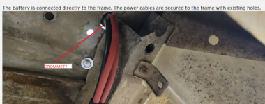

Mounted the battery in the bed with a simple bracket. Studs through the bed floor. I may make some type of enclosure in the future, at least some terminal covers.
Fuses. Subject of debate. The main wire harness has no fuse, nor the alternator, starter, ect. The non-critical branch circuits have fusible links and there are a few glass fuses under the dash. I chose to use a single ANL fuse to protect the battery from a heavy gauge cable short. The fuse is a 150A. Typical ANL will do 100% forever and 150% for 5-10 seconds. This covers the starter current well enough to 225 A. Only the battery can blow the fuse, when cable is shorted. I made a bracket to mount the fuse holder on instead of drilling the bed so this particular fuse setup.
The audio system is also on same single fuse for same reason, 2 ga cable short. They don't need their own fuse as they will never operate at the same time. All cables in starter loop are 2 ga.
The battery is connected directly to the frame. The power cables are secured to the frame with existing holes.
I chose to make the starter hot terminal the main power distribution point of the system instead of the solenoid. This reduces the total cable length both from the battery and not having starter current in the cable from starter to solenoid (that now only feeds main harness and alt). I tried routing several ways to keep the cable away from the exhaust. The resistance and loss in the wire goes up with temperature, and since it is now long, it matters more. Dangling in fresh air seemed better than going over the top of the hot pipes in engine compartment, and didn't need any clamps to secure it away from hot pipes. Not sure it will stay this way, could use a strain relief on starter side.
Wiring on outside of frame to avoid heating. This is the best route from an electrical point of view but not mechanically. I tried not to go up or forward away from battery with the cable.
Engine bay looking more clean and simple.

The truck frame has a very low cross sectional resistance, and would take a huge expensive cable to make any improvement. Unibody is different story as you have found.
My working theory is that each weld is fairly resistive. IF correct that means mutli-section late model truck frames *might* be in trouble too.

I think I would put a grommet where the wires go thru the bed floor. Perhaps work in progress?
Hey Larry,
There is a poorly fitting grommet that popped out there. I didn't have anything suitable so I used a 1.25" plug and cut it up. I have a larger size grommet kit now and need to hog the hole out more or make another. I want the hole/grommet to be large enough to have the wire with lug on the end pass through without ripping the grommet out.
Agree, you've cleaned up the engine bay considerably!
Go around forward of the headers and then double back to the starter? Pic looks like it could work with the length there. Reality is probably different. If that is possible it might offer a closer to the starter strain relief location?
The welds themselves shouldn't have much resistance. I think it is summation of the whole structure, and where the battery and starter lugs are tied in. The new aluminum bodies with glued seam may not work at all.
