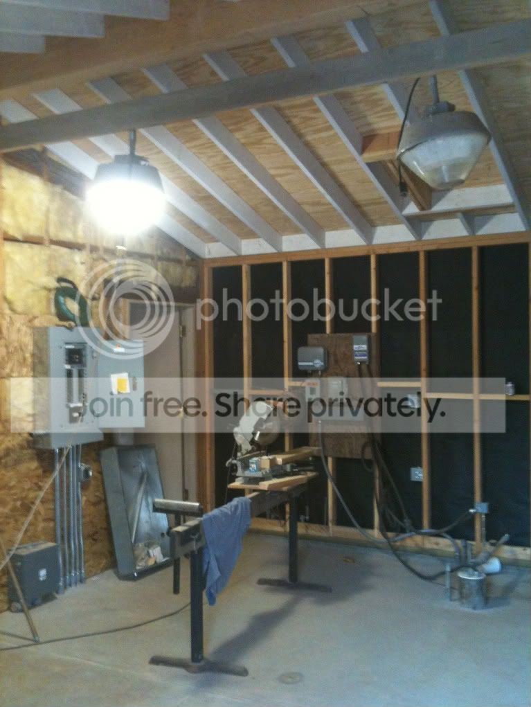

When I added the shed to the back of my garage, slab with small footer was poured at the same time as the new garage floor was poured, I laid up one course of block.
I drilled the slab so each block would have a rebar pin in the slab. Once that was done, I core filled it block a day or two later. I don't think it's going anywhere.
