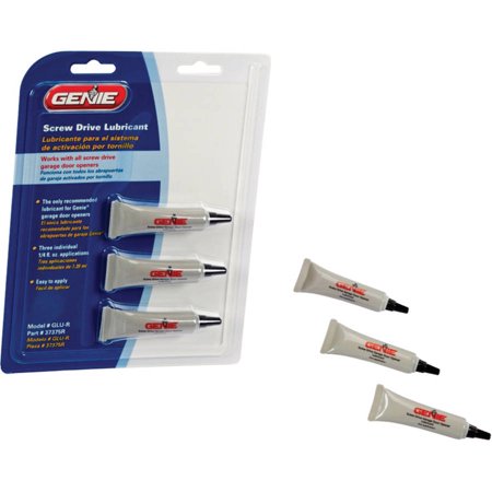

More mention of chain or screw drive ?
They sell specific grease for the screw:
As for track........look for one or more wheels stuck or rusted at the bearing ( usually the bottom wheel).
