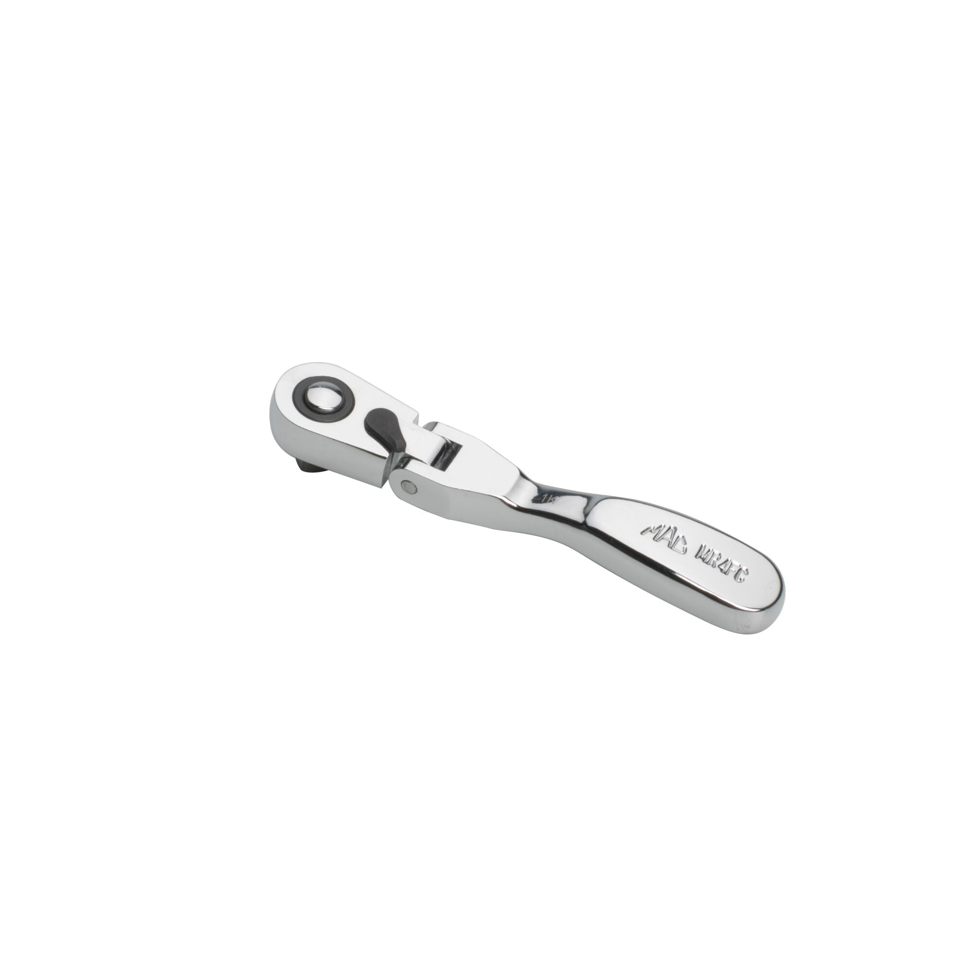

This has always been my favorite 1/4" drive mini ratchet.
I own lots of MAC tools but never got that little guy. Wish I did.
