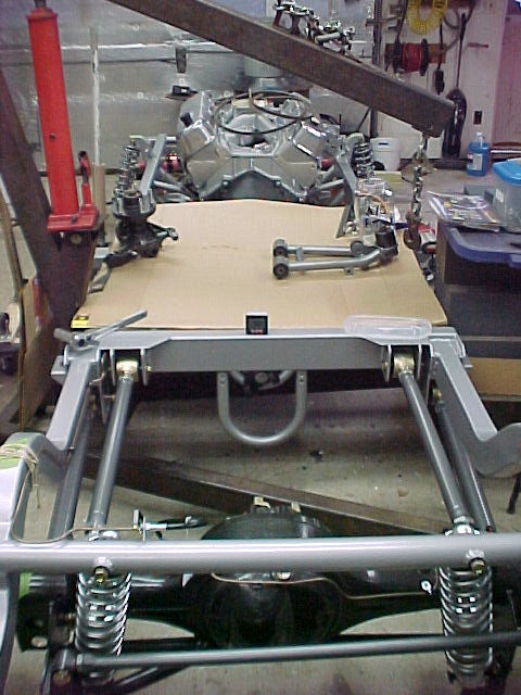

Okay, a few more steps closer to paint. I've been working on a new drive shaft loop since the one I was planning on using is now just decorative. I used the 24" long drop from the 8' piece of 4130 I used for the front bar. Bent it into a 180 and trimmed to length.
I cut a couple of pieces of 1" x 1/4 wall DOM to use as mounting points. These will get welded to the cross member and the loop will plug on.
Drilling the loop for two 5/16 bolts will let me bolt it on for removability. The two mounts will get drilled and tapped for 5/16 x 18.
With the loop made I fired up the welder and did some tacking. Tacked on the loop mounts, the front bar bushing plates, the front lower control arm link mounts and I repositioned and tacked one of the steering stops on the drivers side spindle.
Here is the loop in it's finished positioned.
With all of that done I can start pulling the suspensions apart to finish up the component and chassis welding and start prepping the frame for paint.... It is a good feeling to finally see some progress getting all of the little things done and moving forward.

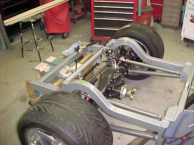

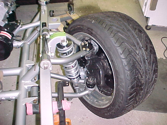

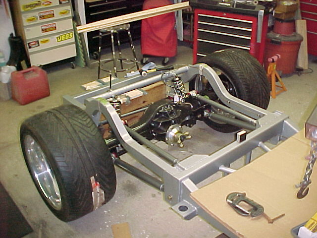

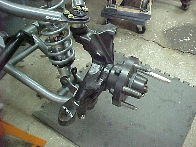

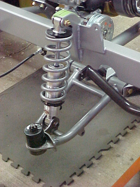

Just a catch up post. The frame was painted in June of '17 and sat in the rotisserie for all of '18. I finally pulled it off the rotisserie in Feb of this year and have been plugging away it ever since.
here are some pics from the work I did last weekend. if you have any questions just ask. :) The rear suspension is done and bolted up. I'll post some pics later.

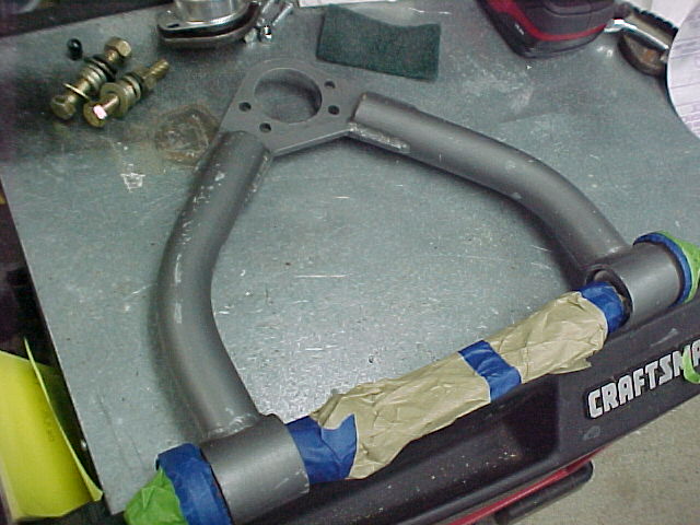

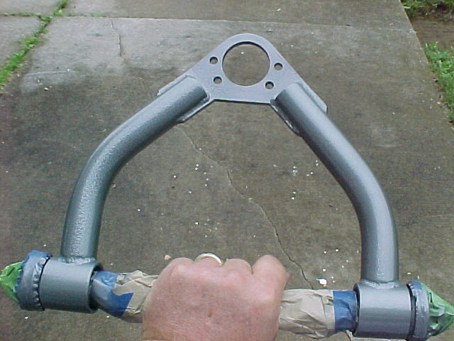

Pulling together the front suspension stuff, I had to repaint the upper arms as they had a hard life during the build stage. Lots of scars and scratches from years of mock up and mock down...
Looks better with fresh paint.

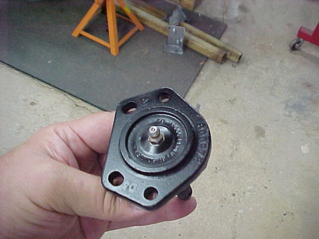

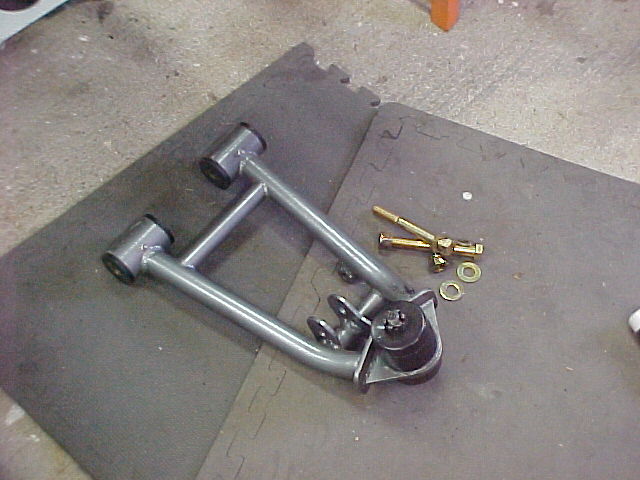

Painted the upper ball joints as well and I am ordering Grade 8 bolts for the UBJ's instead of the cheap azz hardware that came with them...

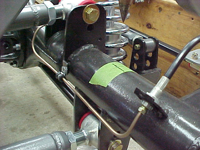

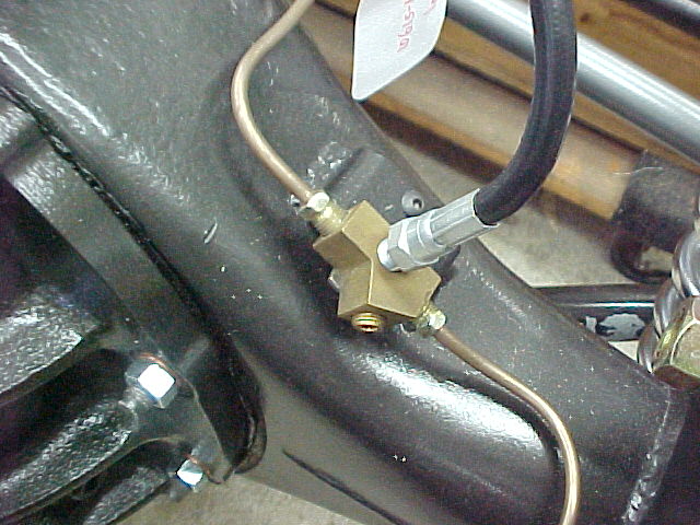

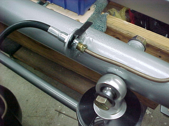

Brake lines are all ran and terminated. Rear end lines are hooked up to the frame and soft line brackets. Front lines are hooked up and ready to go.
I got one of the lower control arms mounted but have to order more bolts to get everything bolted up right.
I got the frame leveled side to side and back up on jack stands so I can work on the LCA's and the steering rack.

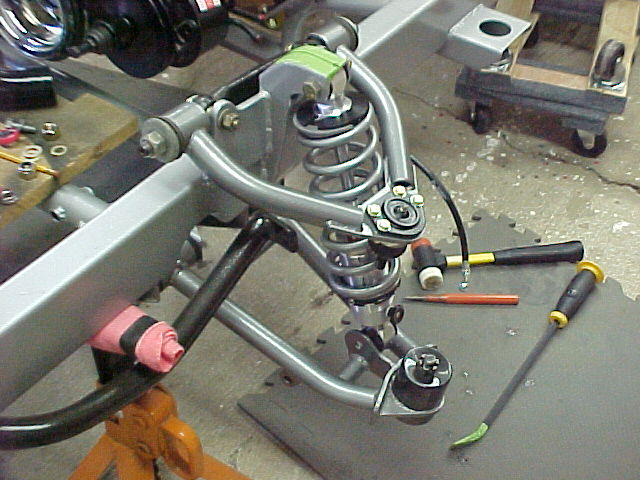

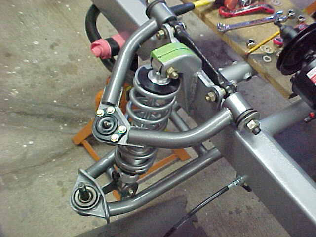

I got the upper arms bolted on.. It will be interesting to see just how close the alignment will be to the "as designed" locations you see here.
With the arms bolted down it will be easier to install the ball joints when I don't have to chase the arms all over the build bench...

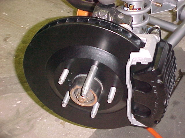

I got motivated after dinner the other night and went back out to the shop and got the front rotors cleaned up. A wire cup brush on a drill motor and a D/A and we're almost ready for paint. I sprayed the rust I couldn't get off, like down in the vents, with rust converter. This turns the rust black and makes a good base for paint.
They weren't in real bad shape to begin with but knocking off the surface rust sure does help.
After some time spent with the D/A.
After a dousing with the rust converter. The inside face.
The outside was clean enough after sanding I will just wipe it down and spray it with the black caliper paint.
These cleaned up very nice and will look "almost" as good as the spendy coated ones once installed. :)

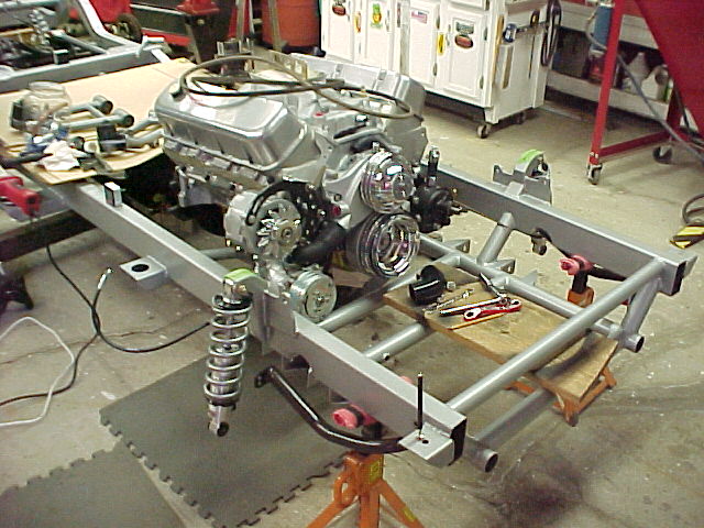

Got a lot done last night. Front rotors painted, rear rotors cleaned up and rust converted, upper ball joints bolted in and the RH steering knuckle hung. I think the rotors look pretty good and I am really leaning toward black calipers as well...
I also got the v-belt lengths figured out. Both Alternator and A/C belts are 51.5 inches long. The PS belt will be about 32 or so.

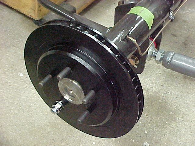

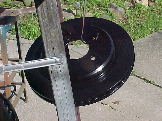

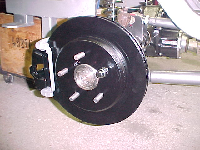

I got the rear rotors painted tonight. It was raining yesterday, not painting when the humidity is stupid high...
Hung in the sun to dry they set up pretty quick.
Waiting for the rotors to dry I started hanging the LH Lower Control Arm. This bolted up easily as well as the shock.
The only snag is I couldn't find the LBJ boot... Looked for a while but no boot. So, off to the auto parts store... I'll find it AFTER I get a new one. :banghead:

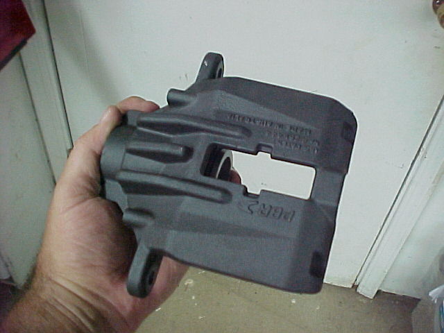

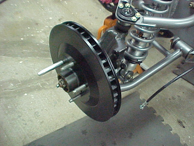

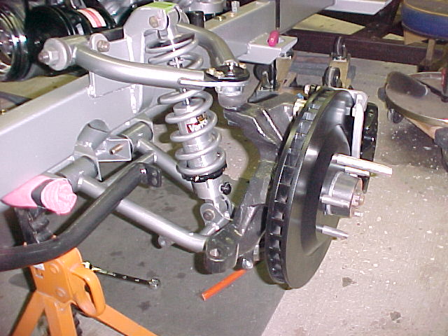

Ordered the LBJ boots through O'Rielly's last week and got the left front suspension together.
With the rotor installed.

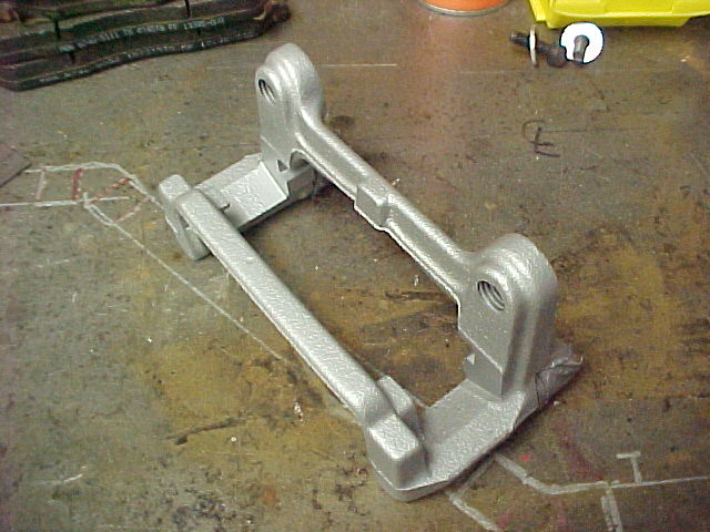

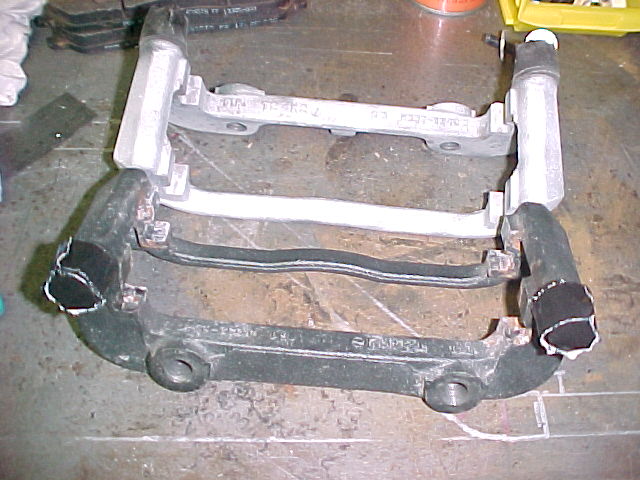

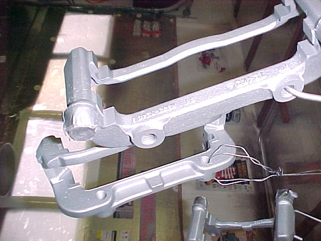

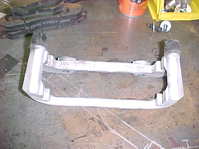

Sunday morning I got out into the shop early, before it got to hot, and blasted the brake abutments and got them painted. I went with the silver caliper paint.
Before and after blasting.
The silver paint went on great and it baked in the sun all day...

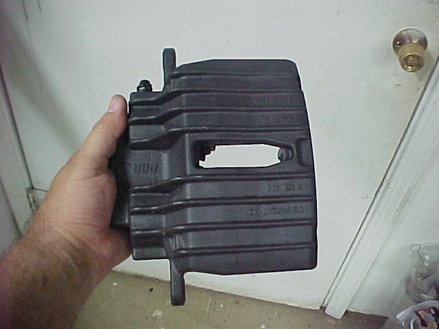

Here are the "grey" Grand Sport calipers.
I got these and the Hydro-Boost cyl. painted with the black caliper paint today. I'll post up pics tomorrow. I have all week off for GM Shutdown. I hope to have this chassis rolling around by the end of the week... :)

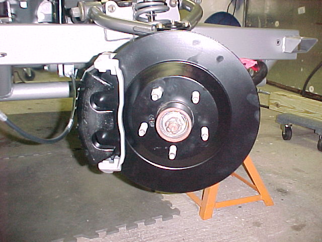

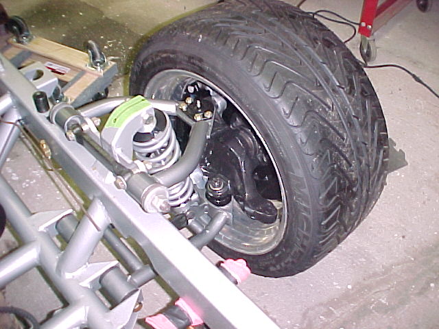

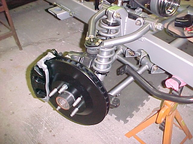

Worked on the front brake corners this morning. Everything is bolted up and it looks like they will work. I will still need to blow everything apart for grease and thread locker but it's much easier to work with clean parts if I have to take it apart for any reason. And I still need to throw some more paint on the hubs. :) The van is a still a long way off from drivable. I should have a rolling chassis tonight though. :)
I'll get back out into the shop later when it cools off a bit.
Right front assembly.
Left front assembly.

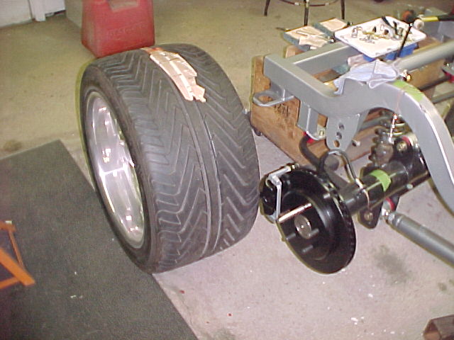

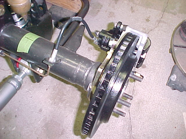

I assembled the right rear brake corner tonight. Just bolting things together for the umpteenth time...:) I like the black rotor and caliper. I think it will look good behind the polished rims.

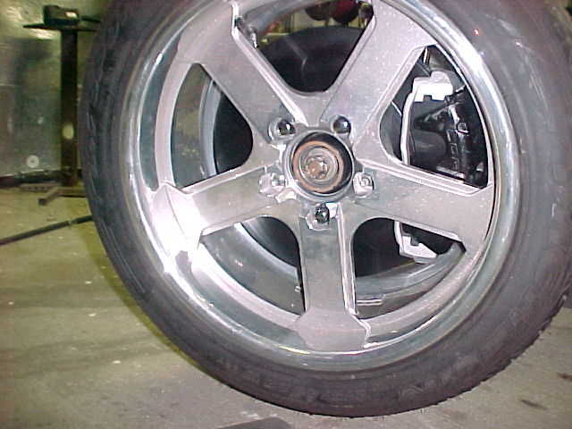

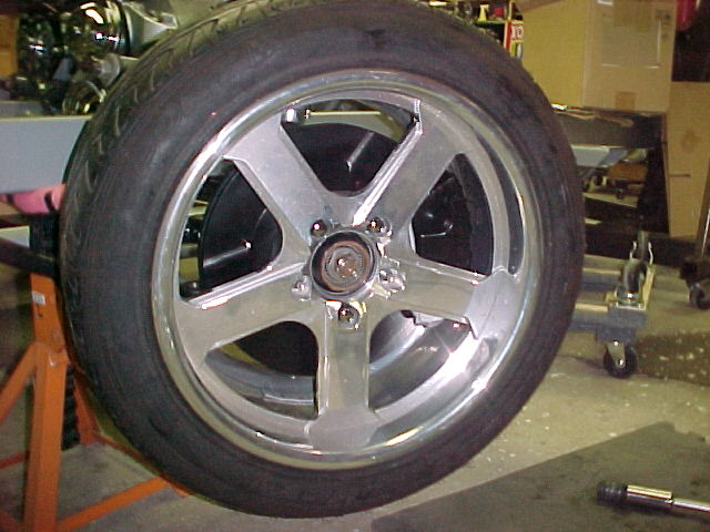

Also got the left front tire and rim bolted on... What do you think?

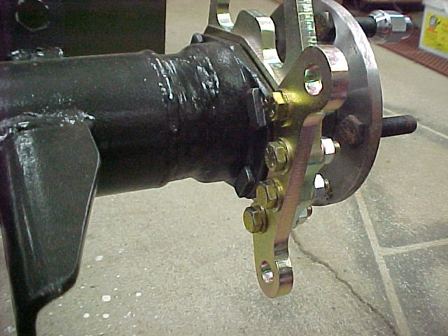

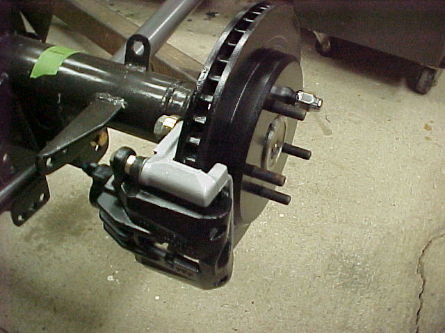

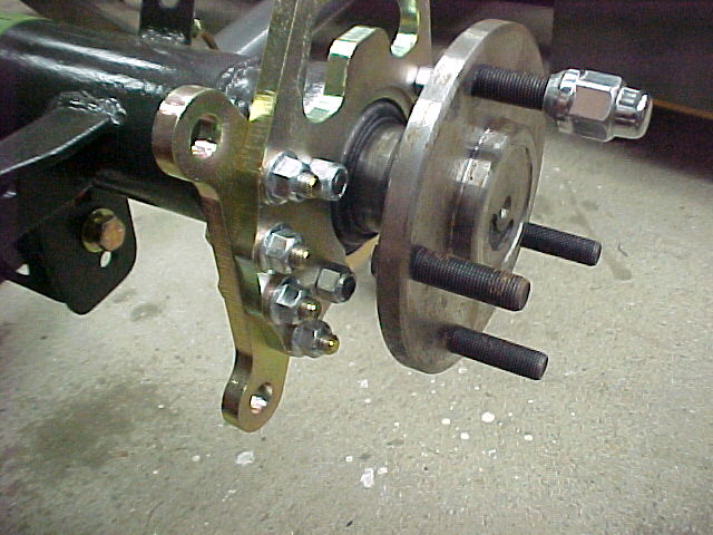

I've had a few people asking about the aluminum abutment adapters. I got those from someone on the Pro-Touring site back in 2011 or 2012. I have no clue who made them.
With the modified spindles there was no room for a bolt head on the upper adapter mount so I used 1/2-20 x 2" LG socket set screws.
Adapter brackets mounted to spindles. You can see the clearance between the nut and the caliper. I had to use short lock nuts on the caliper side to clear the caliper bracket.
All of this was figured out during mock up so it was a simple matter of bolting everything up.
The Corvette abutments take metric bolts and I ordered these flange head bolts (14mm-2.0 x 45 long) and, as with every other part on this van, I had to do some modifying to get them to work.
I had to turn the flanges down by 0.2 inch to get enough clearance between the bolt head and the spindle. I spun them in the lathe and cut 0.2" inches off the OD of the "washer" to let the bolt pass by the spindle as the caliper bracket is bolted on. A stock bolt is at the bottom.
The spindles are highly modified 2" drop Astro pieces. Leaving as much material around the bolts as possible I still had to grind out a bunch to get bolts to fit during the mock up phase.
I also ground a full thread off the length to give better clearance to the rotor.
A bit of a trick getting the Corvette stuff to work but it all bolts up and the calipers align with the rotor so I think we are good to go...

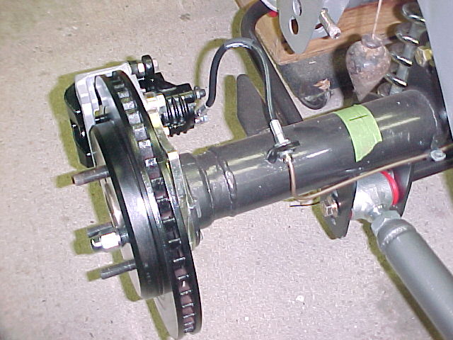

Worked on the rear brakes this morning. The RR was mostly done, bolting up the brake hose was the only thing to do. The LR needed to be assembled but that didn't take long, and with everything put together, mounting tires and wheels was a most do...

Anyway, the build came to a screeching halt after I got the front wheels bolted on. After I spun them one time I remembered a bit of a problem. These wheels have "hidden" valve stems, which means the stems are behind the spokes. When you spin the wheel the valve stem is HARD into the brake caliper... Show stopper.
Anyway, to make a long story short I had the "old" Michelins dismounted so I could work with the bare wheels trying to figure out a valve stem that would work. That turned out to be a no go so my only option was to weld up the old valve stem holes and drill new ones...
All of this trial and error and ordering different valves stems and finally coming up with a solution took a bout a month... At which point in time I was driving the '56 to a show in Flint and got hit by a deer...

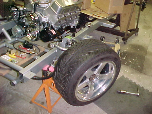

Well, they are holding air! ABC Tire in Flint remounted the "old" tires for me and I got them bolted back on.
Now to get the shop cleaned up and the wagon rolled over here.
A
astroracer
Jun 22, 2005
3,001
Mid_Michigan

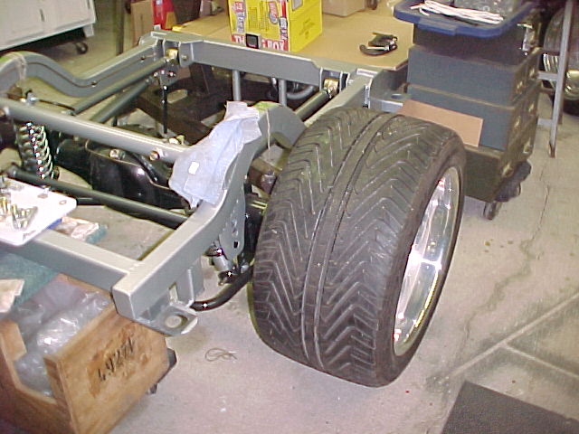

Did a lot of cleaning and vehicle shuffling Saturday. The wagon and Astro chassis have swapped places so I can get to work finishing the cowl on the wagon.
These pics are off my phone, sorry for their largosity...
