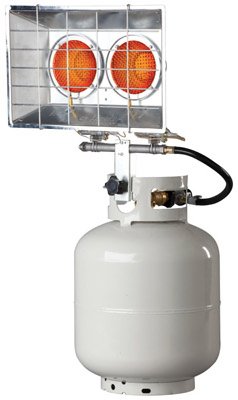

I'm looking for a rec on a temporary/portable heater for an uninsulated attached garage, approx 925 sq ft.
The garage will be getting finished and heated next summer, but with a resto project coming in a few weeks, I'd like to have a somewhat comfortable means of doing work over this winter. 110v is currently what's in there.
Anything fuel or elec that's a go-to for this type of situation?

I have this 30,000 BTU heater.
In a un-insulated garage, at 20F, it will fry your **** while your front side is freezing. It might raise the temp in the garage a couple of degrees.
This unit is 70,000 BTU and is very highly rated on YouTube.

The big box stores handle a propane fired torpedo heater. works good
I have been heating my 1200 sqft with a propane heater. I have the forced air torpedo but it is deafening. I went to a 30k to 80k "construction" heater (looks like a small metal trashcan) with a 100 lb propane tank and it works great - and quiet! But! I would go with a 40 lb propane, the 100 lb is heavy to deal with.
