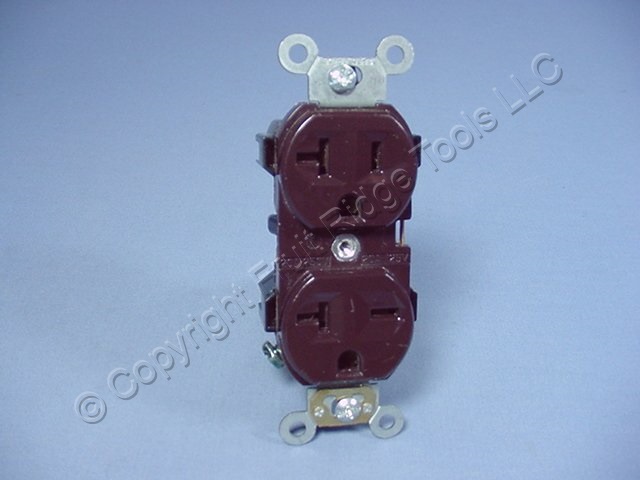

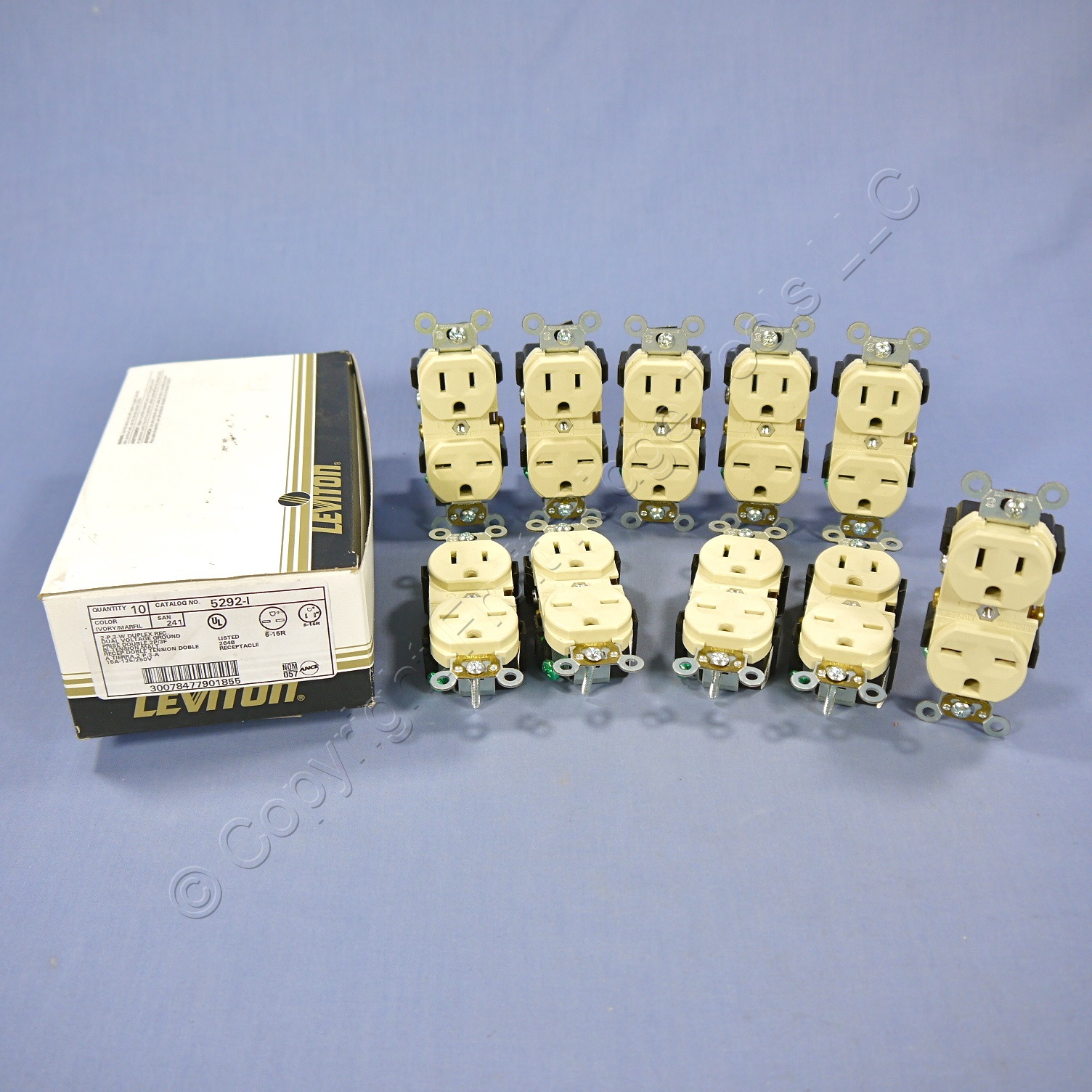

They do make duplex receptacles that are both 120v and 240v
http://fruitridgetools.com/storefrontprofiles/DeluxeSFItemDetail.aspx?sfid=136763&i=249916678&c=0
http://fruitridgetools.com/storefrontprofiles/DeluxeSFItemDetail.aspx?sfid=136763&i=251373747&c=0
Power this from a Multi Wire Branch Circuit. If you ever do MWBC make sure the neutrals are spliced using wirenuts and pigtails or similar, do not use the terminals on the receptacle to make the splices for the neutral. Neutral must remain continuous and intact even if a receptacle is physically removed from the circuit.

Thats interesting. Never seen those. It would still require me to bring down a 240V or 115V lines and necessitate a box extension up top, unless I split the neutral from the 3 wire 240V.
