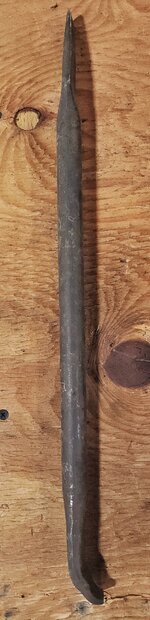

Anyone know what this is - or recognize the logo?
It's 17.3 inches long.
It has a keystone logo with what looks like a diamond inside. (See thumbnails).

^ Keystone Drop Forge of Northumberland, PA had a different logo:
Keystone Drop Forge Works, Northumberland, PA 1910 Logo
Keystone Drop Forge Works at International Tool Catalog Library
Isn't that Chester PA, not Northumberland? I was thinking "Keystone Drop Forge" and "Keystone Forging Co" were two different companies.
ETA: This 1899 ad and 1902 stock certificate put Keystone Drop Forge in Pennsylvania, but both that 1910 catalog and this 1935 obituary refer to it as being in Chester. Which is fine - companies can move - but I can't find mention of them being in Northumberland.
