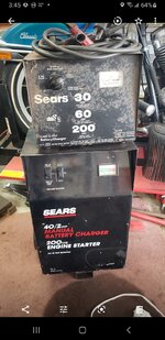

I picked up a big sears charger on wheels from market place 30 dollars. It says "manual". You need to turn it off or it will boil your battery. Sounds like what you need.
