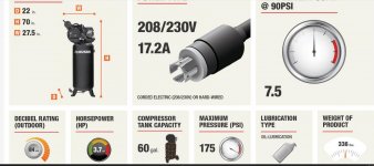

Hey Guys, I am in the planning phase of choosing an air compressor for my garage... The compressor is going in a shed behind my garage actually... I am looking for advise on compressors... I dont actually know alot about air compressors so any input is welcome...I am an above average diy person but am not a professional but I do like professional quality tools :)
I want an air compressor that can handle 1/2 impact guns, air ratchets, and automotive repair tools or some air nailers or that type of air tool for construction. I wont be using a blast cabinet or any of those high air flow required tools... I would like to possibly use a compressor to clear coat my old truck but am not running a paint booth out of my garage.
I believe for my needs I want to find a dual stage compressor based on the possible painting aspect ?
I am thinking a 60 gallon/240v probably fits my requirements the best ? I would rather stay around $800 bucks but also don't want to be dissapointed either ??
I was thinking of possibly getting this husky 60 gallon / 175 psi compressor as i think this may be what best suits me? I don't know who makes husky air compressors though ? I do like that this one has an automatic drain valve and is dual stage but i also dont want to cheap out and have to replace it again in a few years anyway...
I was possibly considering this Napa compressor since it is a little bit more geared toward the professional but this compressor has about the same specs as the husky in terms of air flow, etc... this compressor is almost double the cost of the husky but may last longer ?

I can see by the # of posts that you've been on here for awhile - have you searched this site for an answer? This is probably the most common compressor question asked.
The Husky unit will be fine for your needs. I don't know what box stores are near you other than the orange one, but a 60-gallon farm or box store unit on sale (sometimes as low as $400-450) is probably the best bang for the buck you will find, and it will last for a long time if cared for. My box store 60 gallon IR compressor that I bought in 1990 is still working just fine.

I don't mind the number of posts you have...can't a person just want the conversation?...I'll join...
I think the size you have chosen to be adequate for what you are doing. Dual stage is a must in my book. The "oilless" ones are horribly loud (never again). I would not care about the auto-drain. It's just something to go bad. You'll get used to it working and never check it and the next thing you know...it's holding water and rusting out. I don't know anything about the brands, but I can say that the 5HP model should do better with sand blasting and air tools like die grinders, scalers, etc...the ones that you hold on for extended periods of time. Compare the CFM ratings and you'll see what I am talking about, but in order to do that you need to find out what the husky will do at or near 165 psi like the Napa model rating.
If it were me, I'd lean towards the Napa model. The larger motor should mean longer motor life even if all else is the same. A smaller motor doing the same work will work harder than the larger one hence a shorter life...and it's NAPA (the last ole'school parts store, so I support them with my patronage). Try to find out the country of origins too. I try to keep my money at home when I can.

I'd do a 5hp 80 gallon Quincy. I have a 60 gallon and it does fine, but their is some hoopla on the internet claiming it's more of a residential compressor than the bigger units. It will do fine for my usage. Only has 3.5hrs and I bought it a year ago. Lol

I have a Champion 2 STAGE 60 gallon tank. Great piece of equipment....but your not buying it for $400 to $500 .....

My local Lowes has this one on clearance for a bit over $400
https://www.lowes.com/pd/Kobalt-60-Gallon-Two-Stage-Electric-Vertical-Air-Compressor/1000542193
It looks like the same CH based compressor as the Husky. For the price and given the requirements I would pick this. The bigger Napa unit is "nicer" but costs a lot more, takes up more space and, if it matters, more current when running. Really, I suspect you would be fine with a 20+ gallon 120V model so anything 240V is likely to be great. BTW, slip about 2-3' of rubber hose onto the intake tube of the air filter. It's a trick that CAT quiet compressors do. It really does help and it costs just a few dollars to try.
BTW, the Lowes and Husky models both seem to have the wrong flow rate. That compressor is not a 7cfm model. I think the sticker on the compressor says 11 but assume at least 10.

7-10 CFM is probably enough for the needs you listed. I'd prefer a small portable for air nailers, but in a shop no reason not to use a large one.
In the $1k price range I'd be looking for almost twice that (CFM). It's not just blast cabinets check teh ratings of grinders and sanders.

Part of the problem with choosing a compressor is they all seem to be the same. Once you compare tank size, motor power, CFM at pressure, and maybe some other line on a spec. sheet, they look like just another pump on top of a tank. Are there any small nuances (except country of origin) that people should look for that would differentiate one from the other and possibly justify a higher price point.

How do they seem the same? It shows that you haven't done your homework (reading the 100s of existing threads on this site). No offense here but come on people we have this thing called a search engine now - there is no excuse for anybody to not know something any longer.
Consumer-grade vs. industrial-grade.
What are some differences?
Duty cycle. Industrial-grade compressors have very high duty cycles often 100%, meaning that they are rated to run 24/7/365. Don't try that with a box store compressor. How many starts per hour is another metric to look at (motor heating).
Life. Better pumps have pressurized oiling systems and roller bearings vs. sleeve bearings. Poppet valves vs. reed valves. Some even have nifty oil filters and pressure gauges on them. Low-oil cutoff. Aftercoolers. Most of these things aren't necessary for the occasional home user, but if you can get a good deal on a used industrial-grade compressor, why not? Pennies on the dollar typically.
Downside of industrial-duty pump? Heavy. Parts/rebuilt kit can be wicked expensive. Sometimes special tools needed to service the valves. You may find that just a pump rebuild kit costs more than one or two box-store compressors. Worth it? You be the judge. Do your grandkids plan on using your compressor? If so, then maybe.
That's a short version.
