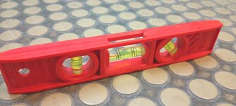

I am not completely happy with the torpedo level I currently have. It's a plastic Craftsman that I got for something like $2 at Ace during some promotion. It's very accurate, no complaints in that department, but the magnetic strip on it is so weak that it might as well not have one. It'll stick where you put it, but so tenuously that any minor vibration will knock it off and it falls. Sooner or later one of those falls is going to knock it out of alignment.

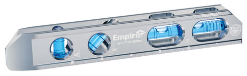

The last torpedo level that I picked up was the Empire EM71-8. Solid body, rare earth magnets on the flat side, handy size. It was to replace a Rigid cast-body level that a vial FELL out of. Rigid no longer has that torpedo level, so I got the Empire to replace it.

Very happy with the Empire em71.8 as well. Billet aluminum, strong magnets, v groove, and legible dials.

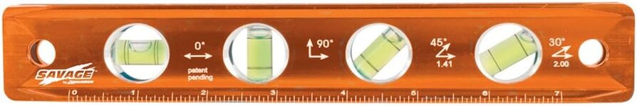

I have the Swanson Savage ,they were the preferred level of scaffold builders. Cheap at under $25, rugged and magnets stick great. Still use mine daily laying out and marking cuts for electrical in our acoustical panels. I'd buy another one on the way home if this got lost or broken.

Here's my old one:
Junky compared to the others, and it will be going to Goodwill, but it has one feature they don't. Do you see it?
The Craftsman has a hanging hole, the Empires do not (unless you drill one yourself :lol: ).
What do I win? :lol2:
Correct, sir!
And your prize is: the respect and admiration of GJ aficionados far and wide.
To be fair, the Craftsman needs a hanging hole, because the magnet strip is so poor that it won't stay stuck to a bench or box.
