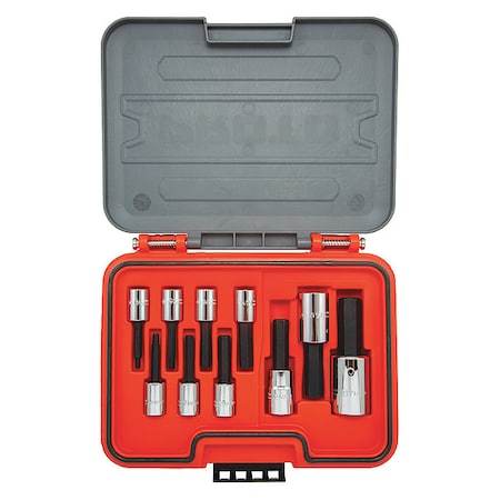

Seems like the J4900MA set has been discontinued and replaced with the J52210H set.
Although the website does show a tether ready version of the J4900MA that says it comes with a blow molded case, https://www.protoindustrial.com/pro...-38-12-drive-10-piece-metric-hex-bit-set?tid=.
149.99 at zoro for the J52210H set.
