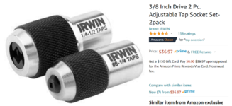

Just use tap sockets with your ratchet of choice. Way cheaper and much more flexible as you can now space the tap out to where you need it without the handle getting in the way. I often use 2' or 3' of extensions to get in tight places that you would never get to with that ratcheting handle.
I was surprised at the number of experienced people who did not even know about tap sockets either!

OP already has tap sockets, and they are not nearly as good for larger taps. It is also much more difficult to control the straightness of the tap with a ratchet. Tap sockets have their place, but they will never replace a proper tap handle.
