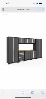

This is the setup I was hoping for. It just fits along that wall.

Pers I would make a platform to raise the outer tall cabinets to sit on. You can slide drain pans and things like that into that space.
then the center part for the workbench I would just have on the ground in front of that step. I would extend that back of the workbench to accommodate a power strip and maybe a airline connection point.
i think the center part sticking out a but will actually look cool

Oh I see. That is going to be very nice. Still I'd skip working on firring out the wall. I'd install it and then get some nice 1x6 boards. Paint them black. Cut one the width of the bench top. Screw it to the bench top so it is flush w/ the wall and closes up the gap. you could also do the cabinets on each side of the bench. On the bottom piece look through all the various trim pieces at your big box store and find and find one 1 1/4" to 1 1/2", paint it black, and tack it to the edge of the 1x6. Now you have a little 5.5" shelf at the back of your workbench.
