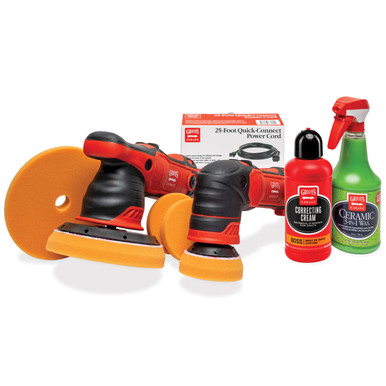

I've been super happy with the G9 random orbital polisher from Griots (https://www.griotsgarage.com/buffers-pads/buffers/). You connect a polishing pad (I prefer Lake Country pads) to it via velcro. Orange pads are great for correction, white for polish and red/black for sealants. If I want to keep it real simple, I use an "all in one" product with an orange pad. After having tried dozens of products, I prefer 3D Speed All in One or 3D Poxy sealant. These products go on with the consistency of skin lotion and wipe off easily without dust. They also won't stain black trim. Very well priced as well. The latest craze is ceramic products and in this group, Turtlewax Hybrid Ceramic is well priced and wins most shoot-outs.
As I get older, I too get lazier. I used to detail my car to perfection, now I'm happy with it being clean and beading water. Now if I get that garage queen convertible I've had my eye on...
