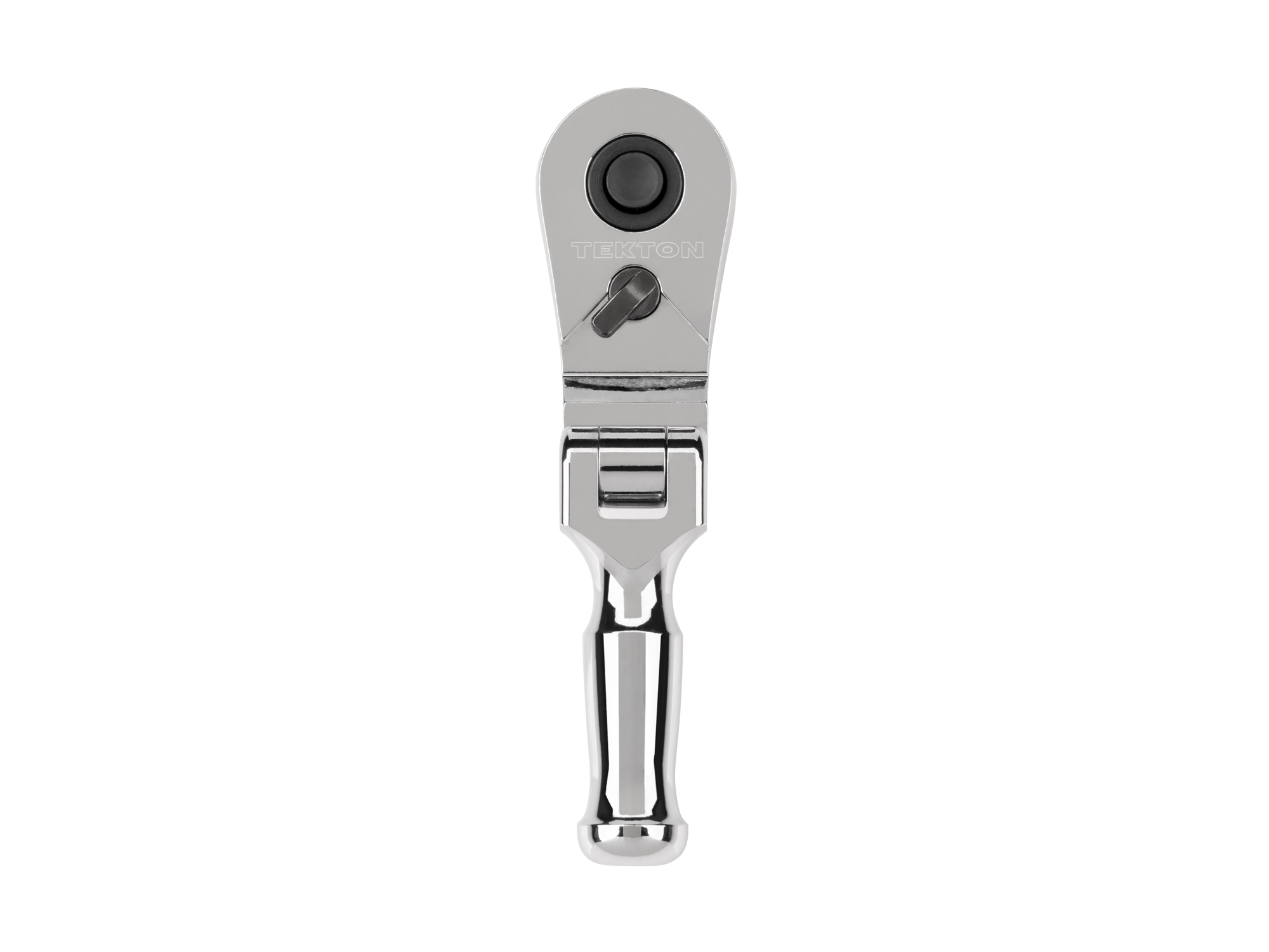

I needed to borrow a stubby socket wrench the other day and found it very useful. The one I borrowed was an older one with a ginormous head on it. I have a gift card to Home Depot and thought I would apply it toward one of these. Does anyone who has used either one have any comments or opinions? I'm a home gamer, so I don't need anything fancy:
Gearwrench:
Tekton (set of 2):
Thanks!
