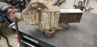

All, I am new to GJ so please forgive me if some of these questions have already been answered in the past.
I have a Reed model 103R that I inherited from my grandfather. (as well as a lot of vintage Craftsman USA power tools and misc vintage hand tools)
The Reed vice is in ok condition, not much rust but a lot of greasy grime, splattered house paint and whatnot. I would like to restore it but I still plan to use it for typical shop work. Should I leave it alone with the existing patina alone or restore? I realize they made tons of these so I know it isn't rare. Also, what color were they when they left the factory back in the day? If I were to refurb. and paint, what would be the best brand/color to use?
Any answers or advice would be greatly appreciated. Thank you.

It all depends on what you like. Some people (me included) like to de-gunk an old vise, clean, prime and paint it in something close to the original color. Others like bright, primary colors--red, blue, etc. Some guys slather boiled linseed oil (BLO), onto the bare cast iron, and let it dry.
I use 2-part, epoxy primer but Rustoleum spray enamel. I've also used Van Sickle tractor paint, which is tough paint, but slower to dry than the Rustoleum. So it's really all up to you. Congrats on getting your grandfather's tools.

thanks, I kind of think I'll restore it. I got hooked on watching the YouTube videos of ppl restoring old hand tools, then I noticed a lot of ppl were restoring vices. With the COVID 19 pandemic and all, I have plenty of free time. Went out in the shop and collected all the old rusty tools I could find. I have a nice drill press with a wire wheel attached. I've enjoyed cleaning up the wrenches. I think I'm ready to go to the next level of cleaning, restoring and painting. The Reed vice would be a perfect candidate. It looks like it was originally painted black. Thanks for your info.

Before and after.
