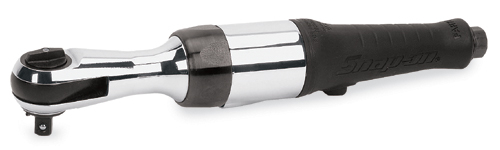

Go right for the jugular. Snap On FAR72C. Power, speed and reliability. They cost out the *** but i've got one at work I've been using daily for 11 years.

bought one of these from the pawn shop for cheap 2 years ago and like the **** outta it...till one day she fell off the lift and the housing cracked where the two pieces met...kinda made me sad a lil if i'm honest...didn't use it every day but damn when needed it makes life a lot easier...and never had any issues of binding or anything else
http://store.snapon.com/Air-Ratchet...Heavy-Duty-3-8-Drive-5-45-ft-lb--P642484.aspx
then i got this one a couple weeks ago in a deal with a mg325, four sets of impact sockets and a gun case...seems decent but it locks up sometimes and won't move...need to remember to tell the snappy guy that this week finally
http://store.snapon.com/Air-Ratchets-Ratchet-Air-Super-Duty-3-8-Drive-5-70-ft-lb--P641430.aspx
but, if you ain't into spending snappy type money, ir is always a great choice...
