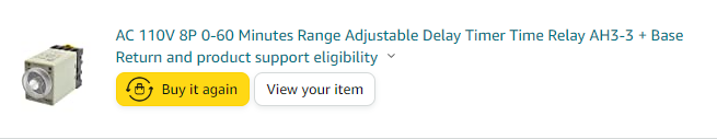

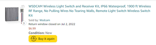

I Installed my first tankless this year when I replumbed my 1953 raised foundation house in Pex A. So I wanted to have a recirc pump on the system that would allow me to remotely turn it off and on when we needed hot water. Several here have mention that having a small tanked water heater is the ticket. Yes if you want hot water fast at every faucet and shower head without having to press a button and wait a minute this is the ticket. That said, You have the expense of the tanked water heater and then the constant heating of that water as the recirc pumps runs even if it is on a temp stat that only runs it when the pipes get to a certain degree you are heating a lot more water every day than if you are willing to use a wireless switch system that turns it off and on as needed and wait the minute or so to have your hot water wherever you want it. I did run a dedicated recirc return line rather than run it back via the cold water line...either way works but you do end up with a little hot water in your cold line if you do it via the cold water return.
I am using a Taco 003 circ pump and it is turned off and on by a wireless remote switch that I paid $6.99 for. I bought 3 so I could use the flat grey on off switches in 3 locations ...and I end up with a couple extra wireless controllers if the first one fails... These are out of stock right now on Amazon but there are a ton of similar products there.
OK so that turns it on but what if I forget to turn it off. dang running that tankless for hours on end for nothing...not good.....enter the AH3-3 time delay. They run between $10 and $15. You can buy them with various time ranges the one I bought was a 0-60 minute range. I would buy one next time that has a smaller time range because trying to get this to shut off after a minute and a half took a bit of delicate dialing. I'd go for a 10 minute timer range next time.
It took a bit of head scratching to get this wired so it would function as I wanted but now when I hit that wireless remote the pump turns on and I have the timer delay set to turn the pump off after it runs for 1 1/2 minutes. When we want hot water in the furthest part of the house we hit the button twice ( to turn the wireless switch itself off and back on ) which actuates the timer again. in a minute or so we have hot water at all faucets and shower heads...definitely the most cost effective and energy saving way of having almost "instant" hot water without sending 3 gallons or more water down the drain to get it or having to run the water heater more than it needs to. The minute or so "wait" to me is worth it.
Happy as a clam
