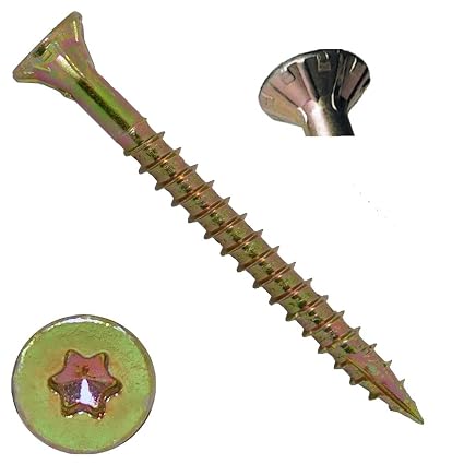

I'm guessing some handyman was talking up the $20/box screws he sold the guy (after markup). My guess is they're torx or security torx.
OP, use your eyes. Or phone camera. Buy a matching bit. R&R.

Even the one way slotted screws can be removed. You can buy a "kit" of tamper proof bits at Oreilly's I know. Probably other auto parts stores too. I took a set of public restroom panels down while remodeling at a 4-H building that used the one way screws. Using the kit from Oreilly's made removal pretty easy.

We need pics of the screws...odds are they come up easily. The worst would probably be the cortex hidden screws with plugs, you'll destroy the plugs pulling those out.

I'm guessing...
-9-x-1-3-4-C-Deck-COMPOSITE-DECK-SCREWS-COCOA-BROWN-1-pound-~145-colored-decking-screw-Star-Drive-Torx-Heads-use-T20-Torx-Bit-Coated-composite-deck-screws-ACQ-treated-lumber-compatible-exterior-deck-screws-good-for-wood-and-composite-decking--27.jpg
I quit using Phillips. The only phillips screws in my screw-box are 1-1/4" drywall screws.
