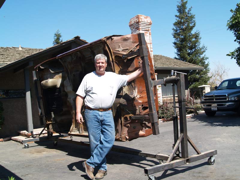

This is an Astro I am building.
Lifted it up in air on the two post, unbolted "most" of the subframe up in the air, set it back down, repositioned the arms under the body and lifted it off. Took half an hour. You can't do that with a 4 post. :)
Sliding the new chassis under the van while it is still on the rotissirie.
Lift the van up, roll in the chassis lower the van and bolt her up. You can't do that on a 4 post. :)
