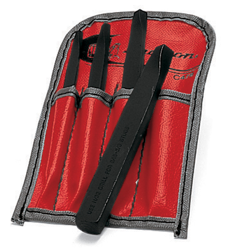

Dumb question.
I've got a broken concrete anchor, 1/2" screw style 4" long, where the head popped off.
Would you just drill it and go at it with an extractor like any other broken fastener?
At home, I pretty much only use the tapered extractors with a slight twist. I assume a larger version of those would work in the anchor as well?
Thanks for the help!

I would order a left hand thread drill bit 3/8" and go to town on it.

Weld a nut on whats left.
Everyone is so quick to try and drill it out. Broken bolts dont break flat thus making for a really crappy drilling spot.

Agreed. Also, tapcon type screws and bolts are made from very hard steels. I expect you'll have an awful time drilling them.

Unless there's some compelling reason (OCD, for example) to get it out, I'd just grind it flush with the floor and put in another anchor nearby. If you have to take it out, and it's not bottomed out in the hole,. you may be able to loosen it up by driving it deeper into the hole and breaking up the interference between the concrete and the little hard threads on the OD of the anchor. This would loosen it up, but you'd still have to have a way to get it out of the hole.

The bolt was in a 15ft pallet rack upright. There are two footplates per upright and four anchors per footplate. It isn't going anywhere or unsafe, but it won't pass a facility audit. The upright was damaged and replace, only one anchor was damaged.
My company would require insurance and a permit for hot work, so I can't bring in my welder.
I'd much rather give more hours to my guys then pay someone to fix it. I'm expecting a facility audit soon, so I need to take care of it.
I'm just going to run an 8" long Hilti anchor to replace it once I get it out. I've had better luch with the Hilti's vs. Red Heads.
I suspect it'll turn easily once I get an extractor in it.
