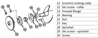

Think I've almost exhausted my options, but never hurts to hit-up the collective wisdom of GJ
Sprocket is on a snowthrower (JD 510 tractor, M03280 snowthrower) - so parts are mostly made of unobtainium.
I've tried heat (propane and MAPP), PB-Blaster and wax, hammers, and a 3-jaw puller. I can get it to slide maybe a 1/16" in/out, but never far-enough!
Just looking for any suggestions, or maybe another set of eyes (or a few hundred), will help me see something I've missed.
Thanks in advance

Sometimes set screws are stacked in a single hole. I remove all set screws and look into the hole with a flashlight to verify. I have had a few items where I had to drill and tap the hub to provide for a puller closer to the center. Pulling on the sprocket OD can cause it to dish and bite the shaft in some cases. More heat and penetrant soaking is likely needed, most likely. If someone in the past has beat on the shaft, it could be mushroomed, and it will not come off without dressing it properly. Power wire brush the area and look really close at it.

I did look REALLY carefully at the set screws - only one screw there, but 2 holes.
I think I'm the first one who ever attempted to get it off - it was virgin before I started. I've been using a punch, or just hitting the end of puller, so no mushrooming of the shaft (just some denting of the gear from my attempts)
I've seen a few recommendations for heat, following by a quick spray of dust-off on the shaft (a quick super-cool).
If that doesn't work, guess I'll have to upgrade my torch set.
Thanks again.

If its sliding a 1/16 each direction its not stuck.(unless the movement is the entire assembly) Something is bent or still fastened, can you get enough bite on the key to pull it first? ( vise grips wth slide hammer) Hard to tell from the pictures but I would work on getting the key to move seperatly from the sprocket/shaft.

  • Drive sprocket back as far as it will go, make sure puller can be installed
  • File or grind end of shaft to make sure there is no burr
  • Install puller put a lubricant on screw tighten as much as possible
  • Use an impact driver or gun on puller screw
  • Heat with your torch and drive puller screw with impact
  • Keep heating and driving constant tension and impacting is the key it'll move

I`m wondering if you could drill and tap through the gear on opposite sides of hub and then thread bolts in and tighten the bolts to the other side of housing to push the gear off.Some pulleys have threaded holes for this .Still may need to heat the hub to get it off.

Set screws create a lip when the press into a shaft or key, this lip catches on the set screw hole and the lip try's to gall to the shaft. Drill and tap the key, or drill the key then use a self drilling-self tapping screw. Thread in until you can use a couple of pry bars to pull the key out. When the key is out you will be able to rotate the the gear and the key slot will fit over the high spot on the shaft plus.
I cant tell how much key you have sticking out but I have used a piece 3/16" by 1" flat steel with a nut welded on end. Cut a notch in the opposite end that just fits over the exposed key, to protect from accidental welding on the shaft, and weld to the key. Use a slide hammer to remove the key.
The closer the puller jaws are to the shaft the better your puller will work. I don't no how many ton your puller is rated for or if you have a two jaw puller but you can cut two slots opposite each other so you puller jaws are able to go through the gear and pull on the back side of the hub. I would use a 10 ton 2 jaw puller for this method.
How much is a new gear? Cut off the old one with a torch, clean up the shaft and replace the gear. Around here you can make your own gear, buy a sprocket that has the right pitch and tooth count, buy the hub with the correct I.D. and weld together. The hub has a pilot that fits semi tight in the sprocket to keep it true while welding. Also look on the web, I found this as an example,https://www.rollerchain4less.com/Finished-Bore-Sprockets_c_21.html

I wouldn't even mess around with a straight bore sprocket.
Assuming you can get the sprocket via # of teeth and the roller chain size, order it with a taperlock hub. I prefer the QD/SDS hubs with a flange, but there are numbered series of taperlock bushings which are flush.
The taperlock squeezes the shaft as its tightened in addition to using the keyway but in general its better at longevity, especially when you have non-constant shaft loads, shock loading (or anything reversing of which this is not). A slip-fit shaft/bore interface has to be tight in order to be long-lasting which defies easy assembly (and disassembly).
If you did put the same sprocket back on, I would consider using a milling machine to drill and tap a 4-bolt threaded hole pattern into the body of the plate sprocket (roughly halfway between hub and minor root diameter of the teeth. In the future you could then use something like a slide-hammer and a simple crossbar to pull the sprocket without fear of damaging the teeth.
Early-on, I (stupidly) hammered the key back - in hindsight, I should have pulled-out the key, then probably could have rotated the gear on the shaft and twisted it off.
... Use a slide hammer to remove the key.
Thank you - this sounds like an excellent next step (worse case, I booger-up the keyway a little, far better than breaking the gear)
The puller is pretty hefty. I agree about the geometry, but not really a way to get the jaws close to the shaft. Furthermore, I can't believe that force on the outside of the gear, would impact the gear's hub (that's a pretty hefty piece of metal)
Thank you - I know the part is N/A from JD, but realizing it's a 1" shaft, it shouldn't be that hard to find a close replacement.
Some of the pulling force can get lost in the flex of the sprocket. that is why I said the closer the puller jaws are to the shaft the stronger the pull. I don't know what size chain runs on that sprocket but I have severely warped 8" 60 chain sprockets with a 10 ton puller. IIRC they are approx 3/8" thick sprocket
I think the "key" to getting your sprocket off is removing the key. Sounds like the key has moved which is a good thing, just need to move it the other way:lol_hitti

A potentially serious blunder as the shaft keyway likely ramps up and has caused the key to bind against the sprocket.
I didn't pound-it hard, but even if it did, I'm pulling the sprocket away from that ramped-up force, releasing that binding as the sprocket moves.
There's no real room behind the sprocket to get something down in there and push from the backside (no leverage either), so I'll be drilling the key as many have suggested.

I have rebuilt 2 of these snowthrowers. I would not hesitate to destroy that sprocket to get it off. Infact many people replace the sprocket with a smaller one for more auger speed. I seem to think that the stock one is 41 tooth and they like to replace it with a 32-34 tooth 1" bore 50 pitch chain.
I have removed all set screws and locking collars and driven the shaft itself sideways out of the sprocket. Takes heat and a whole lot of hammering or a puller and impact. The sprocket can be replaced for $20 or so.

SUCCESS
Thanks again to everyone for the excellent suggestions. Ended-up with just brute force (impact wrench on the puller). Bent the sprocket, but thanks to several suggestions, I've already got another one on order (and some new chain)
