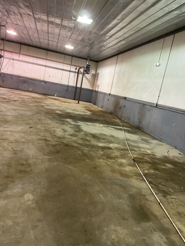

Acquired an old machine shop
5000 sq ft or so
Need some work want some input on what direction you would take it.
Being an old machine shop there is some heavy oil staining on the concrete.
Minimal pitting but the stains are there.
Attached some photos to show some staining (some oil-dri on the floor to pickup some more oil)
What would you guys suggest for the floor?
My initial idea was:
Grind it down, epoxy and seal it, was quoted locally 25k for this which seemed high to me.
New idea is:
Grind it down myself renting the equipment, Seal it, Race deck on top. (11,500 ish for race deck)
Race Deck offered me a fairly good price due to the quantity.
Also if I were to go this route would you suggest the diamond style or the free flow style?
My concern for the free flow would be that it would not hide the staining on the concrete like the diamond style would.
Sorry this is all very new to me so any input would be great.
Thanks

What are you plans for the space? I would start with a thorough scrubbing to see how clean you can get... that'll give you time to think about it the direction you want to go. Laying 5000 square feet of Racedeck sounds like a wonderful weekend project... yeah right! :3gears:

Plans would be to renovate the floor,walls and have about 6-8 four post lifts in it for car storage.

I would just use a buffer with some scouring pads and some really good soap to try and clean the floor as best I could. I certainly would not go crazy to make the floor a showplace if all you are doing is storing cars.

$11K+ for RaceDeck!? For that!?
Hell no. Give it a power wash, scrub it up real good and call it done. At 5000 sq. ft., that place is frankly too big to start invest heavily into the floor. Screw that.

Get a commercial cleaning company to come out and quote pressure washing/rinse/degrease etc but other then that if its going to be a working garage it seems like a lot of money to spend on the floor of a storage area.
If you have an area where it will be more work being done, a paint bay or a "clean" area I can understand epoxy or painted there to make cleanup easier and to better find dropped items....but where you're going to have storage lifts personally wouldn't do it unless these are for rent to a specific clientele that already is committed to paying for that level of finish

Had one come out today to quote it. Will just be my hobby garage basically and want it to be nice but maybe the floor isn't a good idea then. Lets see how clean we can get it

With 5,000 sq ft I'd be looking into renting a ride-on, or at least a walk behind floor scrubber. Something with hard bristles, not just scouring pads. Then look for industrial strength degreaser for concrete. Do the whole floor one way, followed by perpendicular pass. Once scrubbed/degreased you could race deck to your heart's content. Probably won't look like freshly laid concrete, but will surely be clean enough for race deck, or heck just embrace the left over stains and enjoy the space.
Or even...get crazy and get a quote on polishing the floor. Sealers may have an issue with the grease, but at least it could be nice and smooth.

Simple Green is an excellent degreaser. Talk to a rental place and see what they use...
As far as getting it coated? Like everyone has said, that is a major waste of time and money. You will never get it clean enough for anything to last. Get it as clean as you can then have it polished.

Yes going away from the coated idea. Just trying to get it as clean as possible now and slamming some race deck possibly or just leaving it as is.

The floor wouldn't be a candidate for epoxy in my book, I've cleaned concrete with a bristle type attachment on a floor buffer and it worked well. Please post more pics when you can.

Is it safe to leave a degreaser such as purple power sitting on it for a few hours or would you suggest 30 min application then pressure wash off?

My floor had a lot of old oil and trans fluid stains. One really big one when a large bottle of oil spilled and then was left to sit for months. I sprayed the whole floor down with a heavy duty degreaser in a garden sprayer, left it on overnight and then used a pressure washer to clean up the mess. My son kept pushing the dirty water out with a large squeegee. It came out looking almost like new. The room even smelled better once everything dried. It took a while and was loud, even with ear protection but I would do it again in a heartbeat, since it came out so well.
Try a small section with some cleaner and a power washer, let it dry and decide if the result is worth doing the whole floor.

If there is any odor I would suggest getting it professionally cleaned ... think you will be surprised at how clean they can get it. I did a transmission shop and then they used a sealer -- the sealer really had an odor .... but. when it was finished. Nothing ---and the floor looked old but clean. Nice enough that I never did anything more to it

ditto on prof. cleaning
see if they can clean the ceiling and walls first
