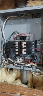

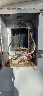

Wondering what pannel I should get and if it needa a disconnect and if the ground and nuetral need to be bonded. pannel in there now looks to be bonded. See pic. Power comes from some kind of old fuse disconnect that comes straight out of meter see Pic. then to shed

All subpanels must be unbonded. You also need 2 ground rods. But is this a dedicated service? Then it's bonded with a three wire feeder and 2 ground rods
Yes do a main breaker panel

yeah someone screwed up on this.
the disconnect is where the neutral is bonded. that CH panel is a subpanel NOT the main panel and therefore should have isolated neutral
I would get a meter main and make sure to unbond the CH panel and add a ground bar to move the grounds off the neutral bar.

Looking at this, I wonder where the disconnect is getting it's power from?
$1 on double tapped in the meter...

The disconnect is getting power from the meter
That's why I was wondering about the new pannel in shed. Is it considered a sub pannel or like a main for ground and nuetral wires

Your disconnect is the 1st point of disconnect, and should be fed by 3 wires.
The shed, fed from the disconnect, needs 4 wires and is a sub panel. The neutral and ground cannot be bonded.
What I'm questioning is how that disconnect is fed from the meter. I suspect it is done in a not very safe, and possibly illegal, way.

There is 4 wires feeding the shed from the disconnect. As gar as the feed from the meter don't know how that was done I'm guessing from the 70s
if thats the case then someone screwed up on that CH panel as the grounds should be on a separate bar. Also, the neutrals are doubled and tripled on numerous lugs. also a no no.
I cant tell if the neutral bar is bonded but wouldnt surprise me if it was
honestly that whole install from the meter pan to the subpanel leaves much to be desired and is why i would just replace with a meter main.

Ok thanks. Also do I need a bigger fuse at the disconnect since I am putting in a bigger sub pannel. Righ now it has a 60 amp fuse
Fuse size is dependent on the size of the wire feeding the subpanel, I have a feeling that 60 is to big already.
bigger sub panel is not what determines breaker size. the wire size does that.
have you actually calculated what your loads will be to determine the amperage you need in the shed?
