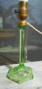

Rather than replace the original switch and socket assembly on a 1930s art deco lamp, I overhauled the switch using a butterknife, a small screwdriver, and an Xacto knife:
Unfortunately current day electrical components aren't designed to be repaired.
