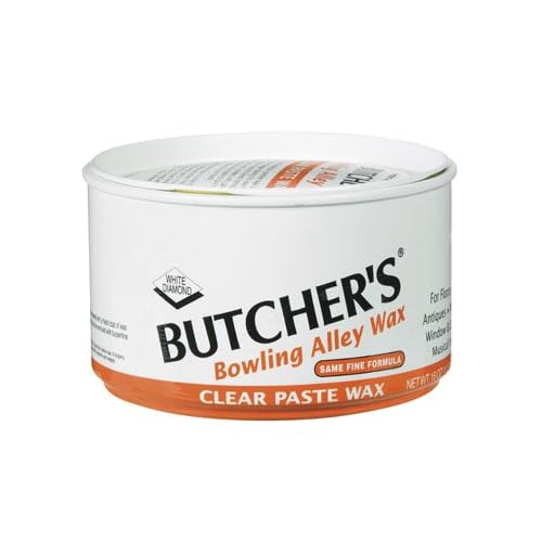

On wrenches and such, I de-rust with electric wire wheel, then smear them heavily with Butcher's wax from the grocery store. After that dries a bit, I give'em a quick wipe down with a rag. This rust proofs them plenty well enough for normal use and of course does not chip away like any sort of paint would. Surface is also much friendlier than an oiled tool.
Butcher's wax? This is the first I've heard of such a thing. What is it used for?

Is this the stuff?
http://www.amazon.com/dp/B000WFYTE6/?tag=atomicindus08-20
Bruce Lancaster
Apr 3, 2006
1,642
That's it...I spend a lot of time in the Non-Food section at grocery; look at anything with scary warnings as possibly useful against rust and crud on metal stuff...
