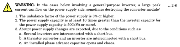

u3b3rg33k
Dec 18, 2017
4,071
I've often wondered why residential submersible well pumps aren't three phase with VFDs instead of single phase motors and motor starters. With a programmed slow start this would greatly reduce generator requirements, instead of starting at full load as they do today.
well technically, all centrifugal pumps start at no load, due to the nature of centrifugal pumps/fans. the issue is the inrush of the motor itself starting DOL, not the pumping. there ARE variable speed well pumps in the residential market - I assume they're BLDC or have good filters because well pumps often have long leads.
a capacitor and a relay are cheaper than active electronics, so cost is the main reason.
I've worked with a few of those, they are advertised to work without a pressure tank.
The 3 that I worked on did rather poorly and I was not able to get into the VFD program so I couldn't adjust the PID (Process Integral Derivative) to fine tune them. So I added a small pressure tank, 1 worked pretty good after that, the other 2 I ended up replacing them with a VFD that I could program and they worked ok.
One drawback to using a small gen with a VFD is often the VFD will not accept the distorted waveform that a small gen produces.
I've never seen a system that didn't have a bladder/tank of some kind. maybe a drinking water/heating system sized tank, but SOMETHING for a tank.
even this has a tank
as for running a small VFD on a generator, the LFP power banks and inverter generators out there now put out nice clean power. if you NEED to run a VFD off a generator, those seem to work great, and since power banks and inverter generators generally have lower surge ratings, the soft start of a VFD is a definite plus.
Interesting... there must be some fault-detection going on in the VFD. Most of the VFDs I've seen rectify the incoming AC waveform into DC to keep a set of capacitors charged; that DC then gets 'chopped' into the 3phase needed to drive the load.
the spec tolerances for input power on VFDs are usually <3% phase balance. a small generator can have a hard time doing that on load changes.
They do but if there's too much ripple on the DC circuit, it'll go into low voltage fault.
The 3Ø input ones will fault out on loss of phase.
Not all VFDs won't handle distorted waveforms but I know of at least 2 that had trouble.
there are ways to program the VFD to be "more tolerant" of noise, there are also VFDs built for extended operating conditions (at additional cost, of course). and then there's input/output side filtering but that's a whole other conversation.
