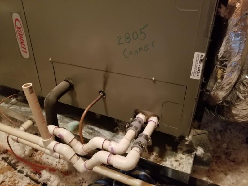

I've got a 3/4" PVC T that is leaking on a condensate line. I've never had to replace something inline before, so I don't know how to go about making that type of connection. Usually I would use a coupler, but since the T is inline with the existing PVC pipe, I don't have a clue how to do this. I know someone here is smarter than I am and can give a suggestion as to make this work.

Nothing better than a picture:
The T is tied into the condensate line from the HVAC, which is to the left, out of the picture. As the condensate line travels from left to right, it is intersected by a T from the water heater overflow pan. That T is leaking, so I have to cut it out.
So, it looks like I need to cut the T out maybe 3-4 inches to the left and 12 inches to the right, then glue a coupling on the left side of the condensate line, glue in a new T, reattach the overflow line from the water heater. Then add a small length of PVC pipe to the right side of the T and use a compression coupling to tie the two pipes together.
Sounds like a lot of work. Looking for alternate suggestions.

pbon
May 14, 2017
3,498
If it is the lower pipe, it looks like it might have enough flex if you unclamped it to replace the tee without a compression coupler. It may also be possible to be able to drop it into place if you redo a longer section. I don’t know what is to the left or right.
But since it is just a drain pipe, a simple rubber sleeve can replace the compression coupler you think you need. You just have to find a piece of hose that fits. You can buy plumbing pvc rubber coupler for a variety of sizes at HD or Lowe’s but I am not sure I have seen one that small. Basically slide the rubber hose down past the end of the pipe, move the other pipe into place and pull the rubber hose back over the joint and clamp it. Again, I would do this at only one end of the new tee section you make to insert in place of the leaking one. Glue the other end with a pvc coupler. PVC is really cheap; the glue set might cost more than the pipe parts.

Did you check if that joint is glued? I don’t see any primer at the tee and it seems unlikely that a condensate line would develop enough pressure to leak unless it wasn’t glued.

I have used 3/4 automotive heater hose to splice PVC pipe. Works great and gives you a place to take it apart to clean 10 years from now. Just a couple of hose clamps and you are ready to use. Do replace the T fitting and glue stubs in and then splice with hose.. Do keep the hose pieces short enough so they cannot kink between the clamps.

Fernco makes a flexible coupling for 3/4" pvc pipe. They are often used on condensate lines to make cleaning easier.

The fernco type coupling is what I have used, but a piece of any rubber hose that fits should work if you happen to have a bunch of random hose from car projects.
