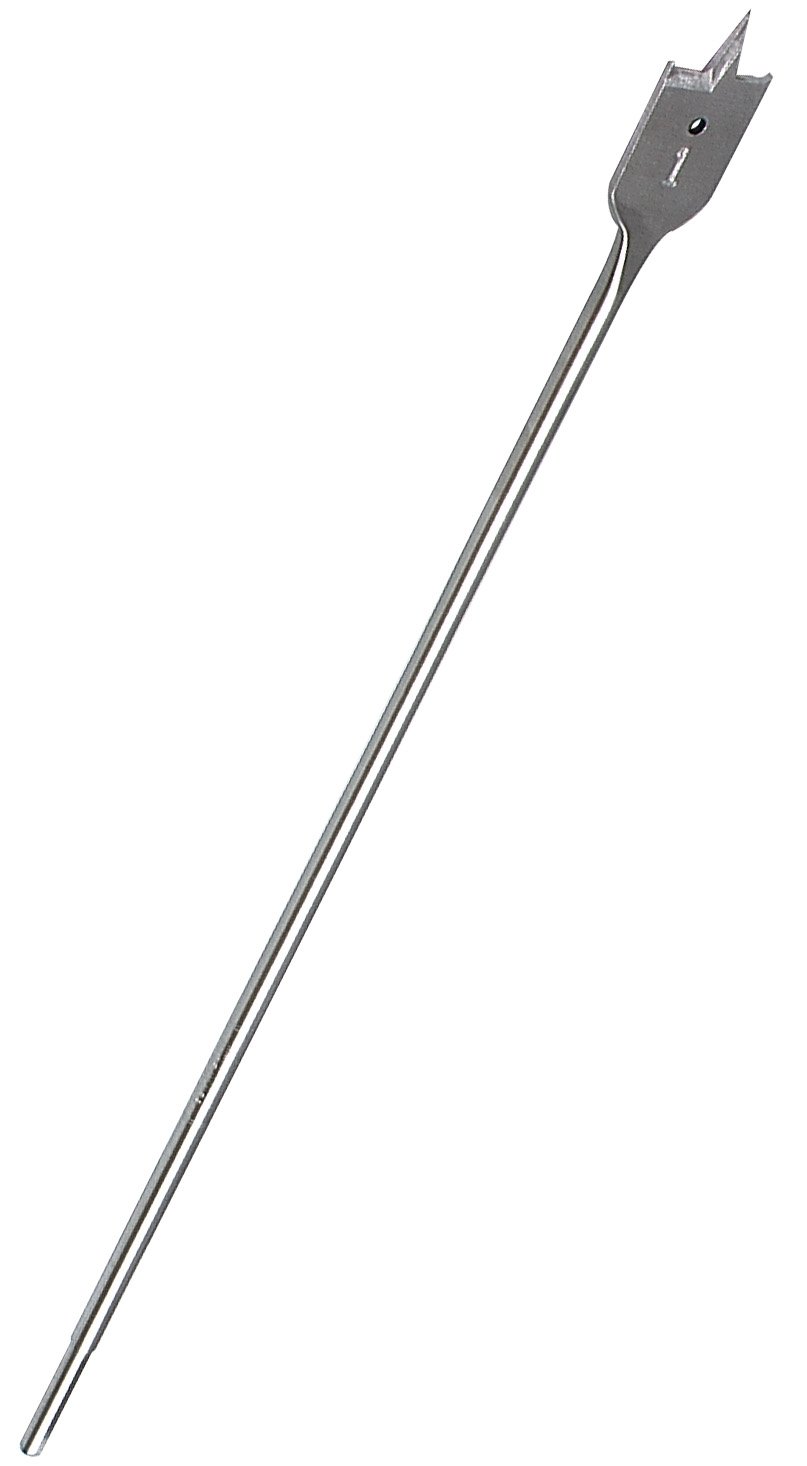

Use this to chew the postout, it won't take that long while using a shop vac to clean out. Then, set your steel post and pour epoxy around it. JMO

I suppose it's possible to remove the 4x4 from the concrete, but I am not aware of any specific tool to accomplish that. I suspect that not only is there a concrete slab that is around it, I suspect the hole was dug at least 24"deep as well and filled with concrete too. Normally you would just cut around the post and jack hammer the concrete out.
However,I guess you could cut the post flush and long spade bit and starting drilling it out. Once enough material had been removed you could take a spud bar and finish breaking it out, similar to drilling out a bolt that was broken off. Are you planning to put the new post inside the old hole?

Big drill ("Hole Hawg"), big drill bit. I think an auger style bit would be better than a spade bit.

I respectfully disagree on the auger vs. flat bit. The hole at the bottom of the post could be solid concrete. The auger bit will pull in to the wood fast and keep pulling and may hit the concrete , plus there is the potential the auger bit binding up and the jammed up drill smashing a person's hand against the concrete edge. A lot of wood chips will have to be vacuumed anyway making it a stop and go project anyway. Just makes more work un- hanging an auger bit screw ...every time its vacuuming time. JMO

I agree with gregtwojeeps regarding the paddle bit.
Though I would not cut the post at ground level first.
I'd cut it at knee level. Then drill a horizontal hole or two through the middle of a side just above the ground. Next, saw a cut in from the side to the hole, and then split the post down to this hole.
Now you have a handle. Now drill out half the underground post, and use the handle to pull the other half once it's loosened.
