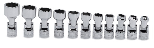

Forget the semi-deeps. Now is the time to take advantage of the discount program and buy 1/4 drive swivel sockets in chrome 12 point shallow. No other tool manufacturer makes better swivels and they're extremely expensive at full price.

Question, why get swivel sockets if I can just use a universal? I don’t plan on being a full time mechanic, so I think I can do without.

Swivel sockets are indispensable when you're in a situation where you have to go in at a fastener from an angle to clear an obstruction. Combined with a long extension, they can really save the day. A universal joint is very useful also, but they require more room; and most of the time when you have to go in at an angle, you won't have that room.

To answer your question on why buy swivel sockets instead of using a swivel; they work infinitely better, and take up less length so give better clearance. They are extremely useful.

i think they guys who are telling you you need chrome swivels are crazy. i have sae swivels in 1/4 and 3/8. can't tell you the last time i used them and i work on a wide variety of things. grab 1/4 and 3/8 swivel adapter and be done with it. wobble extensions are more useful.
i do however use the **** out of my impact swivels in sae and metric and sae deep . why? because an impact wrench is much larger that a ratchet or breaker. it is also worth noting that a swivel impact will deliver more torque than a swivel adaptor and socket or extension swivel and socket.

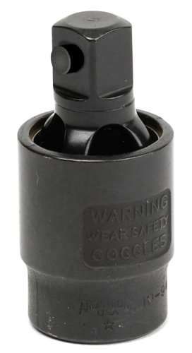

And get your self one of these and you'll be sitting pretty. I'm sure MATCO sells one in their brand.
Armstrong 19-947 3/8-Inch Drive Impact Armstrong MAXX Universal Joint

Can the Proto swivels go in at an extreme angle? I can lean my Snap-on swivels over almost to a full 90 and they'll still turn. Craftsman don't even come close to that.
