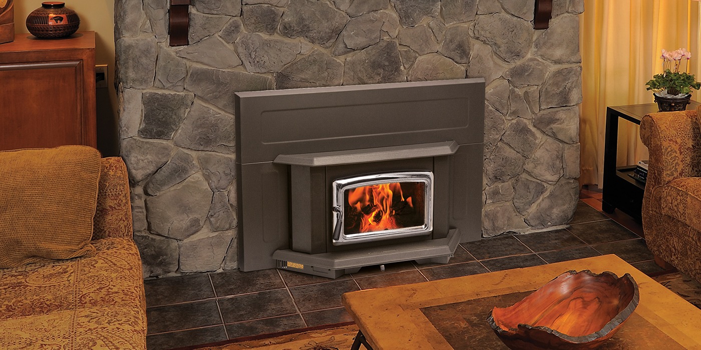

We just installed one of these:
$8300 installed, including the chimney
So far, we're pleased with it and the heat it puts out. The blower is a bit noisy, but not obnoxious.
