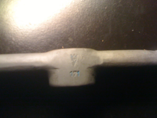

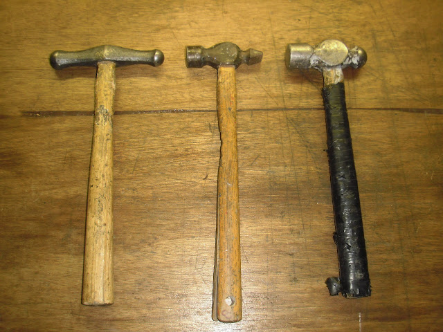

Geurt that's some nice work so far, welcome to the addiction! I don't recognize the logo, but the octagon shaped handle is a nice feature. As for the old stuff, generally even the cheapest dollies are still worth using after some reshaping as ZRX61 suggested.
BHH - thanks for the compliments! You're correct the flat part is for pounding metal, the "spike" or pick side is also for pounding metal. Generally a pick hammer is used to knock down a tiny high spot or sometimes to lift a tiny low spot if you can access the back of a panel. Chisel and cross peen hammers are used to create creases, bends, or induce a linear stretch as you pound the metal. They are designed specifically for hammering on unhardened sheet, the faces are hardened steel and polished smooth so you don't mar the metal. The handles are lightweight for easier swinging because they don't require a ton of strength. Even the flat end comes in several different shapes or crowns depending on the geometry you're hammering on.

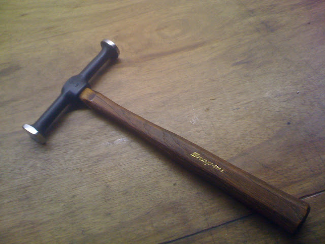

I bought another hammer today, this is the first "restoration" I have done on a brand new hammer! This is a Snap-on BF632A, new old stock from the truck with a 2003 date code. I don't like the fiberglass handles, so I cut it off!

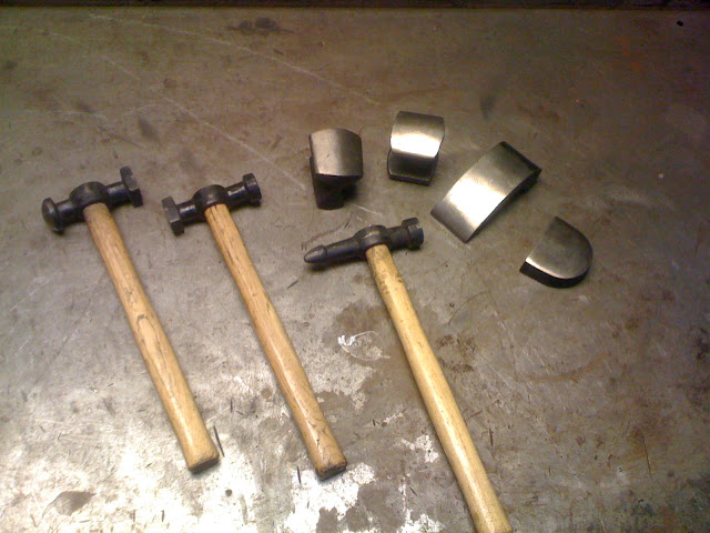

I found this interesting. The handle eyes on the older hammers (BF6xx) are assembled as-forged with no finishing. This eye is clearly milled to its shape. I have never built another BF6xxA or BF6xxB hammer before, mabe this is standard on all the newer ones.
As it should have been from the factory!
