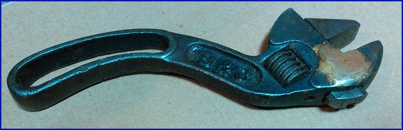

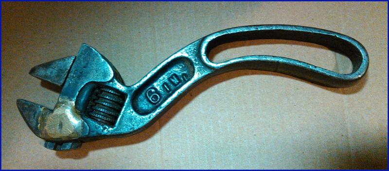

How far do you go? I’ve got two here.
First one I cleaned up minimally and did a crappy job grinding off where the jaws were deformed outward. Still not remotely square when they mate. Any meaningful reason not to file the jaws flat and square? It’s not a museum piece.
Second one doesn’t really need much more than cleaning up the jaw deformation. Seems like that would make it easier to get in close to the work without scratching it up. I could also file the round ways smooth. What do y’all do? Clean up or leave alone?

If not rare and made by the boat load then yes by all means take a surface grinder to it if you have one or can use one from a shop or best friend. Even a mill can have a go at it, but then only if you can find some kind of source for a mill.

A sharp mill ******* file, a good eye in good light and one can make the jaws mate so precisely light won't show.

When I deal with a deformed piece like that, I peen the the raised areas back toward where they came from before filing/grinding to restore the contours. This reduces, but does not eliminate, the gaps left by the missing material.

Are any of these hardened?
The one I was filing on had a hard-ish spot but mostly pretty soft.

I have dozens of early adjustable wrenches, and find many that no longer work well or have missing parts. Generally, if I can remove the screw I disassemble the wrench and thoroughly clean it. On Crescent brand wrenches I make sure that the jaw tensioning spring is present. If the wrench has been abused and the jaw won’t slide all the way in, I do some filing until the jaw surfaces meet. When re-assembling, I put a drop of red loctite on the screw threads and a bit of boat trailer grease where the adjuster rides. I’ve had to make several replacement screws using machine screws with shoulders, cutting off the heads and hacksawing in screwdriver slots. There is no use in owning a wrench that doesn’t function properly, in my opinion.
