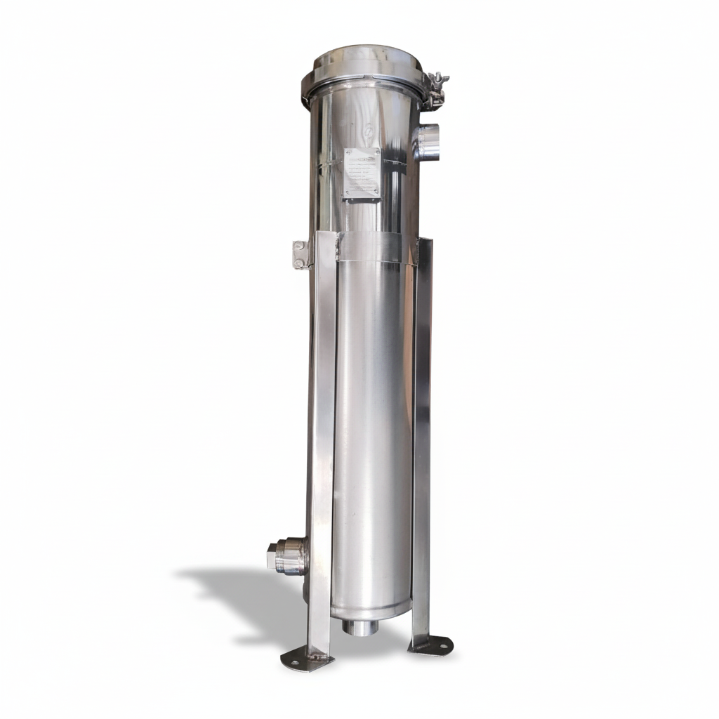

My water filter project got out of hand, it all started with a decent amount of iron and manganese, and progressed on and on.....still have a bit to go. At this point I have a giant 10"x40" pre-filler, (2) 10x54" Katalox light tanks, (2) 10x54" Catalytic charcoal tanks, aeration tank, (2) low micro after-filters and a cycle stop@ sensor monitor
Have (2) stainless UV lamps housing in parallel. If they stay on all the time it heats up the water and costs roughly $170 a year in electric, then bulbs need replacement every year. So I rigged a dual timer relay to keep the well pump off for a variable amount of time, set for 10 seconds so an aeration system and my UV lamps start before the water flows. The UV bulbs need to warmup before the UV is strong enough to disinfect, thus the delay. Actual I am going to increase the delay amount to 20 seconds. I am aware switching florescent tubes on/off often is not good, Hopefully in the near future I can get LED UV lamps.
The dual timer's second delay circuit is rigged to turn off the pump if it run continuously for a variable time period, have it set for 1 hour and 30 minutes, and must be manually reset. I do not water my lawn so there is no chance I will run the water that long but a busted pipe might. My advantage is I have 160 gallon in pressure tanks, so the pump does not energize much in a day.

10x40" filter is huge.... Bet that's a pain in the *** if it doesn't back flush.

This is the pre-filter I have, has no backwash, paid $300 on Ebay. Uses filter balls within a basket, requires cleaning once a year, but catches about a pounds of ferric iron/manganese. With all the filtering the only chemicals it does not catch is nitrates/nitrites which my aquifer does not have. Far cleaner than any city water, I can fill a bottle with water, 3 weeks later no sediment, wash my car or windows, not a spot .
