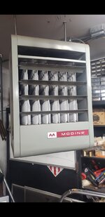

Well the 125k is on order, more post to come when I get it. Since the distributor didn’t have the 150k in stock (they only had the 125k and 175k) I knew the 175k would’ve been too big so I went with the 125k so I didn’t have to order from somewhere else with the possibility of getting it damaged when it got here.

Heater has arrived! Just need to get it hung and vented, going to have the gas company do the gas run.
