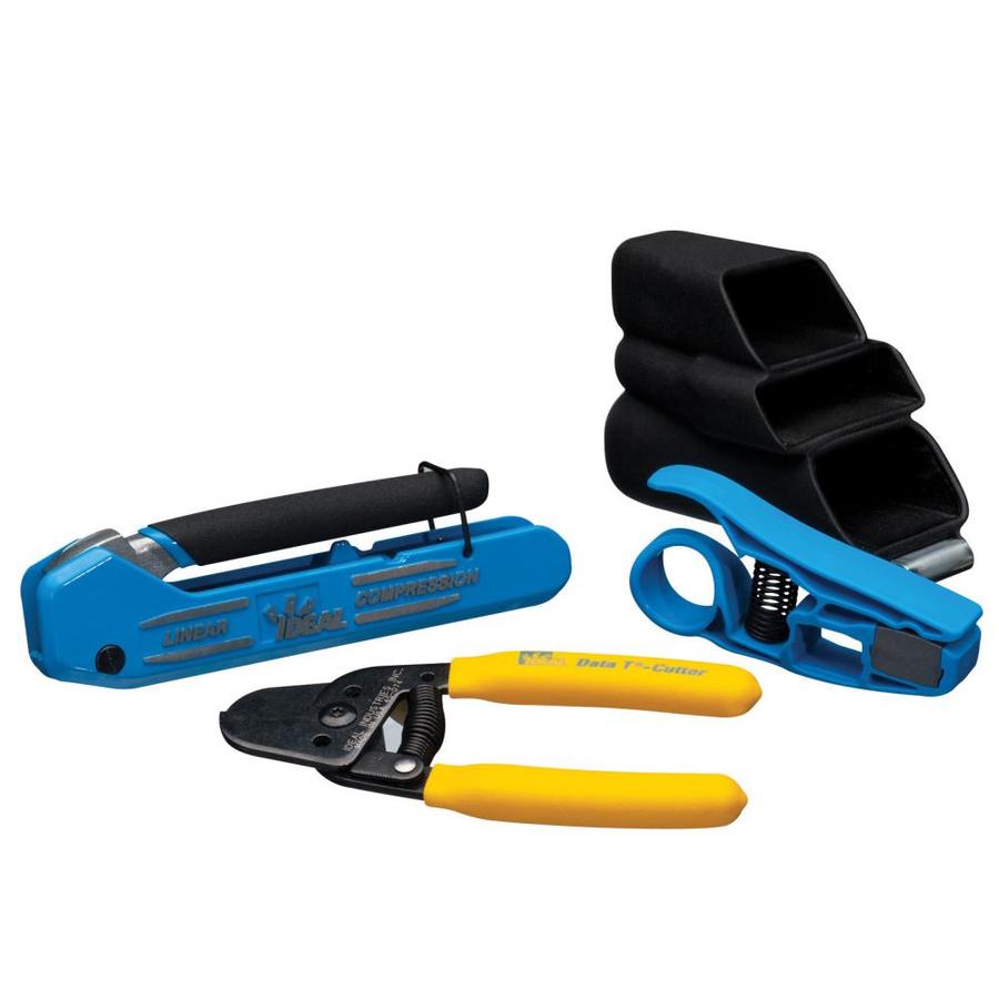

just got around to another project - moving a RG6 cable to a new location. The last time I messed with RG6 or RG59 one used hex crimpers and connectors, rather than compression connectors. My understanding is that the compression connectors are far superior to the older style and tape to seal. I will do maybe 4 to 6 connectors in the next 10 years. Can someone recommend a good brand connector and a good brand tool set. Also do the older style hex crimpers have any value? If not I can't see leaving them in the tool box to take up valuable space.

cable is already in the attic and wall. Prefab is out. I am thinking compression fittings, compression tool, and stripper. My old way of pocket knife, wire cutters, and hex crimp tool is not as neat as today's compression fittings. Tools can range from $15 sets to $150 sets. No idea what works and what does not.

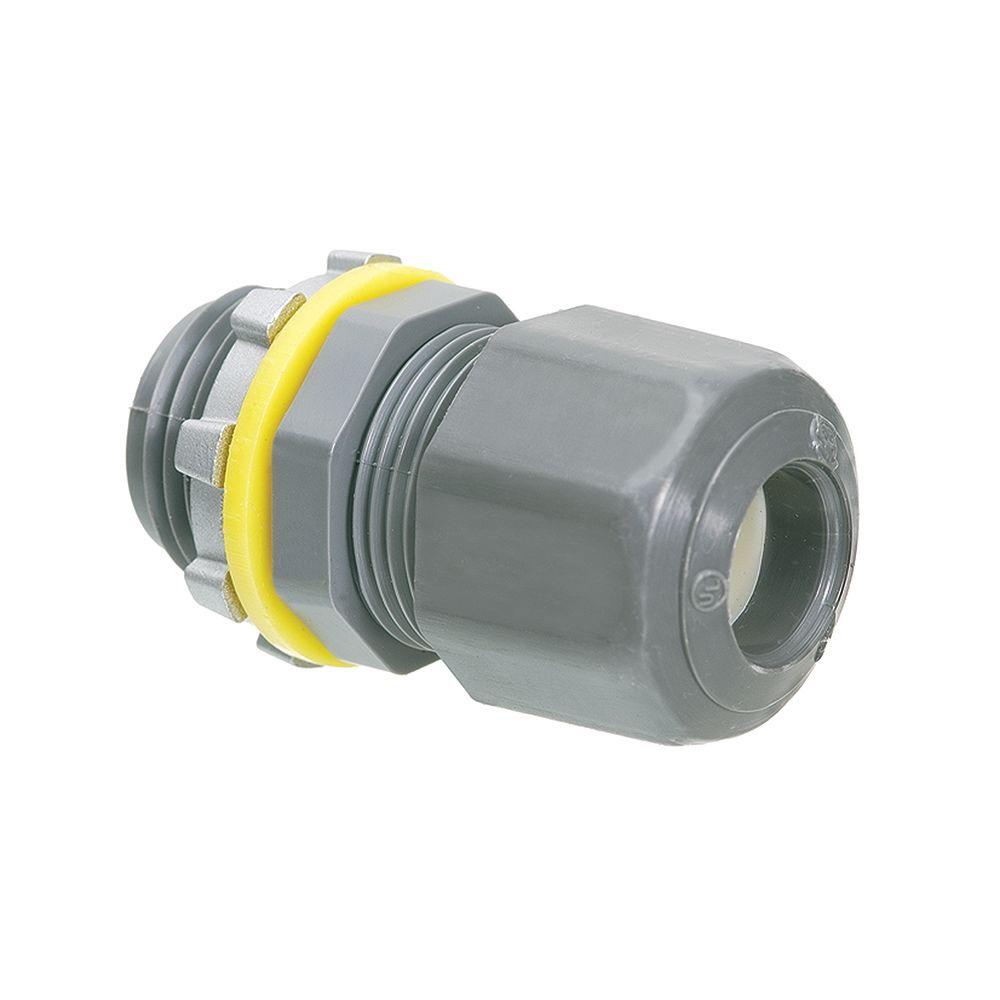

ALSO - I ran grey electrical conduit under the lawn and concrete to the house years ago to make it easy to pull a new coax cable. Does anyone make a fitting that goes on the end of the grey electrical pvc that the coax can exit thru? I'd like something better than just caulking it, which is what I did with the sprinkler wires, but I can do that. Don't know if the cable company will like it but the way the do things they may never even notice.

For Strippers I have both this one:
https://www.amazon.com/gp/product/B00939KH0M/?tag=atomicindus08-20
and this one:
https://www.amazon.com/dp/B006C4CGLE/?tag=atomicindus08-20
For just cable, the Platinum Tools is far superior. The universal is difficult to get adjusted to different brands of cable to avoid cutting the braids on the second cut.
I am currently using a Klein VDV211-048:
https://www.amazon.com/dp/B07G3BRDK3/?tag=atomicindus08-20
I switched from a non-adjustable Ideal brand because it was over-compressing some fittings and splitting them.
The last time I bought compression fittings, I bought these from Amazon:
https://www.amazon.com/gp/product/B00B8CISSU/?tag=atomicindus08-20
I used to buy them in bulk from Menards or HF, but both drastically increased pricing last time I was in the market. Never had a problem with either fittings.
I ditched all of the crimp fittings. No real need for them once you have the compression tools.

Snap-N-Seal is the brand of connectors you want. (The brand has been bought and sold a couple of times in the past 10 years. I believe it is currently owned by Belden.) SO MUCH BETTER than any of the crimp type.
I the "official" tool, IT1000 because it is a combination stripper and compression too. (You will notice from the Amazon listing that they reference two other companies, Thomas & Betts and Augat, They both own Snap-N-Seal at one time or another.)
The proper RG6 connector is a SNS1P6. It is blue.

I have the Klein VDV211-048 Compression Tool and Klein Klein VDV110-061 2-Level Coaxial Cable Stripper. Both work extremely well and dead simple to use. Purchased them at Home Depot. I also use the Klein connectors.
I bought them when we canceled DirecTV and installed a roof mounted antenna. I ran Belden RG6 Quadshield.
I was thinking about this set because it is simple to obtain and Klein usually works well.

I have the older version of this set. $40 at Lowes. The only reason I upgraded was to be able to do BNCs and 90 degree connectors.
https://www.lowes.com/pd/IDEAL-Linear-X3-Compression-Hip-Kit-Compression-Tool/1000404645

used the two tools for the first time. Wow, will never work with an old style F- crimp connector again. How slick the new ones are. I used Belden connectors. One tool strips perfectly, peel outer wire shield back, insert onto f-connector, and the other tool compresses perfectly. Done. I did one test one to adjust the compression tool and other than that it was a 1 - 2 minute job. What a clean solution.
I went with these above. Worked great. Used Belden 1532A which is underground approved and Belden EX6XLPLUS connectors. Dug the front, laid new conduit yesterday with the help of a neighbor, pulled it yesterday afternoon, and finished pulling the area behind the fence this morning. That conduit was put in maybe 15 - 20 years ago. Cable is complete and tested all the way to the audio / TV room. All done and I am so happy about it. When the contract with DSL / TV is up this fall I can move to cable and higher speeds. We get too many TV dropouts in the evening with Consolidated. My old crimp stuff will never be used again. These are so clean and easy to use compared to the crimp style. Painted the cable to match the house this afternoon and its done, Lord willing.
