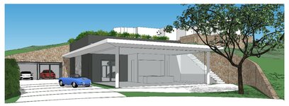

Instead of building a garage and posting it to find out everything I did wrong - thought maybe I’d post early in the process and just build a better garage. Reading through a lot of peoples posts I know that one size does not fit all. But this community seems to be very helpful and positive so I am hoping to harness some of that.
The garage is being built mostly underground. It will go under part of the existing lawn and then we will add 4,000 sqft of lawn to cover the rest. The current floor plan that I have doesn’t show the shop sink and washer/dryer in the storage room and most importantly the urinal in the bathroom. The architect had the washer/dryer in the bathroom and that was an easy choice to move into the shop to make room for the urinal. The rest is pretty straightforward. Ceiling height I believe is 14’ in the main garage and slopes down to 9’ at the double bay garage. The elevation was a previous rendition before I added the storage area. Let the games begin.IMG_0090.jpegIMG_0153.jpeg

Looks like a nice layout, are you planning direct access from the house above?

There is a walkway through the yard to the long stairs you see on the right side of the glass portion of the garage. Not sure I love that access. San Diego doesn’t get much weather so that helps. One thought was to modify the side garage. I asked the architect about making it the height of the backyard. I was envisioning triple stack lifts with a glass front. Then on top a bathroom for the backyard and an elevator.
I hate elevators cause all they do is break. And the eye roll from the architect told me my idea was going to reflect poorly on the budget. Heheh. So maybe that’s out. We have 4 single garages and parking for 7 up at the main house so this garage is just for the fun cars.
The distances involved and the hillside make a direct connection very difficult.

Looks like a fun project, I'd be looking into A+ waterproofing, personally I love CETCO Bentonite Waterproofing Products, Swelltite for the walls, Voltex for under the floor if needed. I'm not a fan of peel and stick asphalt-based waterproofing.
You'd have to call them for the roof, I think they use Voltex but I'm not sure. Don't forget the Bentoseal for imperfections and tie-rod holes, just smear it on potential problem areas. And Hydrotubes are great on the exterior footing/wall junction, these last two items could easily be installed by the homeowner and up the long-term water resistance 100x for low dough.
Spancrete Roofs tend to leak where the spancrete sits on the wall, personally I'd request that area above grade but it's not possible if your underground. I'd get a few opinions of the best way to seal it with concrete, then I'd smear Bentoseal over any mortar and lay Voltex. or Swelltite, over that covering the roof and part of the wall at minimum.
We have a lot of old-folks buildings up here with parking under the building, usually V-shaped and 3-5 stories. Some of those get lots of water when it rains entering in between the basement (parking) wall and ceiling. Sometimes water sits in the hollow tubes of the Spancrete and after 20 or so years, the rust marks start bleeding through.
If your in San Diego or a similar place, they get it too but it's usually during the January Rain Storms.

The waterproofing part of the puzzle is terrifying in my mind. I have mentioned I want the ceilings to have angles in the pour to direct water where we want. I have a firm belief water will always win so rather than hope and pray it will lose, build for it. One new product was mentioned and said to be bulletproof - don’t believe it. I will research all the products you mentioned. Unfortunately the roof and walls will meet under 3’ of engineered soil to allow the law to grow above. That will of course mean a different water penetration from the standard soil so just one more problem to deal with and overcome.
Appreciate the insight. Apparently there is a fault line on the property so have to deal with some more soil engineers. Before going to the Coastal Commission. All fun I guess. Initial meeting with city planning at the end of the month. Had a brief conference call with the department who brought up some possible hiccups but doesn’t seem like anything that can’t be dealt with. Good Times!

Attached an image showing the existing lawn with the added lawn as a result of the garage underneath.

Made some modifications to the design to bring it a little inline with the architecture of the main house. Not exactly a match but at least some lean towards the min house. Main house is craftsman style so the all glass and concrete look was in very stark contrast.
Has anyone had any experience with BendPak’s PL-6KT -> 3 wide lift? Was thinking this would be nice to remove 8 posts from the equation. The documentation is inconsistent as far as how many locking positions it has. One spot says 1 and another says 7. 1 seems pretty dumb but maybe. Don’t like the way the crossbeam blocks the lifted car but at the end of the day not sure how important that is when compared to getting rid of all those posts.
