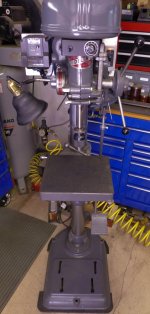

I'm going to pick this one up soon.
Any thoughts on this vs pm 1150a VS?
T-slat production table vs smaller clamp table
17" vs 15"
3 1/2" column vs 3"
1974 casting quality vs 1989 ugly Gold PM
Should be fun comparing the two over the next few days.

I had that exact DP. It was a well built machine but I liked my Delta 17-600 + VFD much better so I sold the Rockwell. (not a big fan of Reeves style VS)
I'd would still take the Rockwell over the PM1150 because of it's larger capacity and table lift.

Both have table lifts, but the extra capacity is a plus.
What don't you like about reeves drives? I like the big grippy belt vs the small ones. A little wd40 really helps keep them quiet.

Noisy, more vibration, need to run it thru it's speed range frequently, VS parts can be very hard to find/expensive if ever needed.
By contrast I can change speeds on my VFD'd DP600 with the twist of a small dial, it's quiet and smooth.
One of them had to go and this is the one I kept. To each his own.
The Reeves balances torque and rpm while maintaining horsepower so you get lots of torque at low revs—-unlike a VFD which at best will maintain constant torque. Much easier to stall a VFD drill press with hole saws or large bits.
That's true but I upsized the motor to 1.5HP so have never stalled it out even at the slowest VFD speed w/big bits. I've never had to move the belt from the highest speed setting but could if I ever needed to.

Well, this Rockwell is most likely going to be parted out.
It's missing some pulley parts and these seem to be fairly rare.
Overall I do not like the pulley construction compared to powermatic. The springs are held together with a weak snap ring that obviously does not hold up over time.
I do like the return spring setup and of course the big column and base. The base is probably too big to fit in my space... it is pretty massive. The way the head clamps to the column is also way better then the cylinder locks powermatic uses.
I think the reeves drive weekness outweighs all of the other benefits though. I do have one email sent for the parts and if that works out I might get it running again.

Looks like I may have a source for parts so this drill may live on!
It is currently completely disassembled on the floor.
I cut off the welded on rack and it sprung out violently. Apparently it was bent so they just welded it to the column. Currently working on sanding down the welds and then I'll see if I can get the rack straightened out.

The stars have aligned, and it is starting to look better for the Delta to stay in the shop.
I found a clamp table on ebay and already sold the t slot table to a owwm member in CO.
The pulley is due for delivery tomorrow and the table on Saturday so I should be able to start using it this weekend. After testing I'll decide on paint and new bearings.
UPDATE: The pulley is here! Looks to be in good shape.
I just pulled apart the spindle and everything looks good inside. Also took apart the chuck and will clean that up next. Then I can start getting the head back together. The spindle pulley is kind of challenging to get together so that will be the hardest part.
The spindle sure looks a lot like the dp-600 version but does not have the play I had with two of those models.
UPDATE 2: Spindle pulley is all together, just need to fine tune the adjustments. I'll get the motor pulley on in a few and then tomorrow I'll mess with adjustments and get the new table installed.

I kind of got side tracked with my new grinder, but have been working on the press as well. I took the head off today and got all the head raising parts cleaned up and installed. Replaced the head / rack and it works great. This will be a welcome addition since options are always nice to have, even if they are seldom used.
Now I am attempting to get the belt and pulleys lined up and I cannot find a manual that goes over how to set the pulleys properly. Seems like the powermatic went together much easier.
My plan is to get the spindle nut set as close as possible and then remove the belt and level to the motor pulley. Originally I tightened the nut all the way down but then you cannot go through the speed range... raise it up about 1/4 inch and it starts to look pretty good.
I went with a Fuji vfd this time. No reviews on them anywhere but they seem to be a step up from tuco for not much more money. Hopefully I have a running drill by the end of the week.

Finally got to test the motor and vfd.
The Fuji seems fine with minimal testing. It's nice and quiet since it does not have a fan.
I still need to wire in the switch and pot, and figure out the settings for each.

That machines has the perfect spot for the VFD speed control/switch. I'd also suggest another switch that disconnects the VFD from main power.
Dial down the machines VS dial and then dial down the VFD and that machine's speed will be super low with unstoppable torque.

Yeah that's pretty much my plan.
I got it wired up thanks to you tube, the manual is worthless.
Everything works great so far. Maybe I'll actually drill a hole tonight.

The PM1150a just moved on so it looks like the decision has been made.
I took a quick pic of them side by side this morning...
Now I just need to get it moved into it's new spot.
Overall both machines are perfectly fine for my use, but extra capacity of the Delta made it an easy choice.
