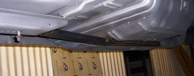

Just wanted to add these pics of my Mustang for reference to feed the mind.
This is where the main hoop sits and the kicker bar that rides down from it to the outrigger from the subframe connector. Since everything is black, it does make it hard to see.
Here's the outrigger (2x3 tubing) from the bottom. Compared to the top pic, you can now understand where the hoop/kickers are welded to.
The front of the sub frame connector (2x2 tubing).
The friend that put in my roll bar has put in numerous roll bars/cages and back half'd 25-30 cars over the years. Mine was the first foxbody he had done this way. The next one he did, he lengthened the sub-frame connectors up to past trans mount and brought them up through the floor a bit.
FWIW, you can see the scratched paint on the sub-frame connector, that's from me jacking up the car.

Ok, the subframe connectors are in. Pics to follow. I ended up using the Control Freak subframes, but it would have been almost as easy to make my own and go through the floor.
Now that the subframe connectors are done, I plan to patch the floors and the front passenger inner rocker so the roll cage is sitting on solid metal. The seat mounts will need to be fabricated and welded to the floors as well.
