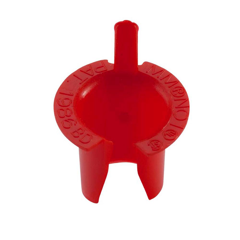

If it IS legal to route Romex through such amoring (See https://www.homedepot.com/p/AFC-Cabl...-AFC/205070934 ) where the NMC enters or exits the armor (and is not required to be "protected") do you insert one of these of the appropriate size in the end of the armor so the Romex insulation is not cut/chaffed?
https://www.homedepot.com/p/3-8-in-...MC-Anti-Short-Bushing-35-Pack-75401/100170558

then pass through an Anti-Short Bushing inside the wall cavity ( https://images.homedepot-static.com...743a22/svn/conduit-fittings-75403-64_1000.jpg
Obviously using FMC as I propose WAS legal at the time the drier circuit was installed and passed by the City Inspector, but I know codes can change, so I am asking if what I am describing is STILL code-acceptable.
Bob
The picture is for an anti-short bushing in MC Cable(although it's not required), AC cable, & 3/8" flex.
The armor of all metal flex of the '40s, was made of very heavy galvanized steel. It was a ***** to cut, even with a hacksaw.
Today they produce reduced wall steel and aluminum flex, which the armor can be snapped, and easily cut with tin snips.
