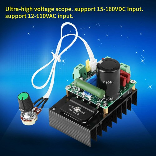

walta
Jan 13, 2017
2,321
Dutzow Missouri
Assuming the motor you have had brushes, permanent magnets and two wires.
I like Dart brand motor controls. This one on EBay seems to fit your needs.
bubinga
Jul 26, 2014
12,744
Looks Good. AFAICT, looks darn near like A KB 120.
Didn't check if you have to add a resistor for your application?
IIIRC KB 120 is the ones I have. where you have to add the resistor.
One of them should work too I would think.
