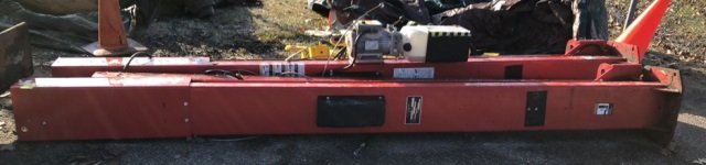

Looking at this auction for a Rotary 2 post lift, but the auctioneer is unhelpful in providing details and it's online only. Can anyone ID this lift? They claim its 9,000#. I'm mostly curious to know if it is symmetrical or asymmetric, and approximate year of manufacture. Looking at the arms, they appear to be different lengths, so I assume its asymmetric, is that a safe bet?

The tag on the column will tell you everything, which they probably don't show you in the pics?
Example: SPOA9, with the "A" being for asymmetric, and the "9" being for 9k.
Unequal length arms would definitely be for a asymmetric lift.
